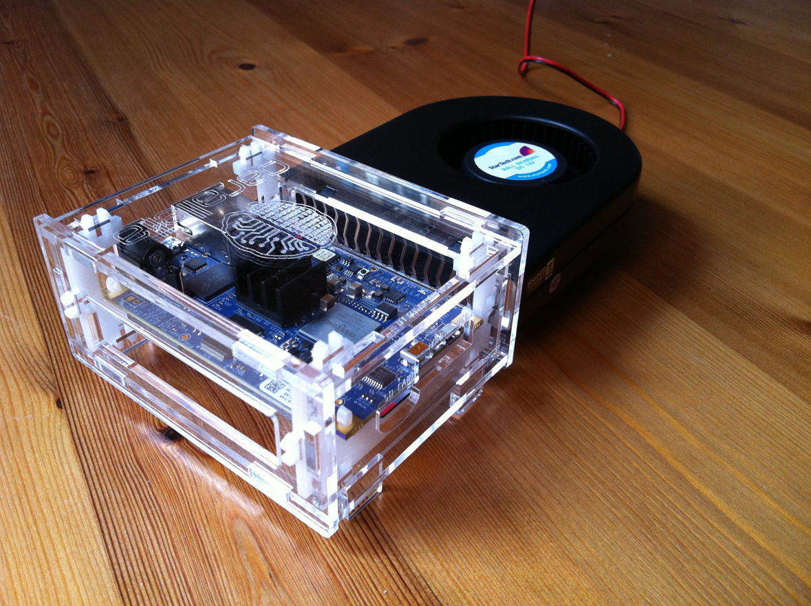

Postby akidner » Thu May 15, 2014 8:45 pm
I am attaching a picture of my cooling solution. It’s a standard 12v PC case exhaust fan. It was a very low price but quite fiddly to fit. I run it a 5 volts so it is quieter and slower than in normal use.
PC case exhaust fan mounted on the side of the Parallella case
