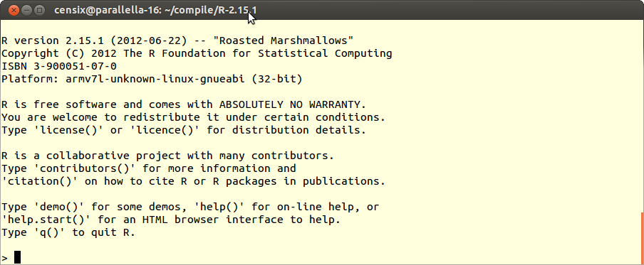

Postby censix » Wed Jun 12, 2013 8:01 pm
