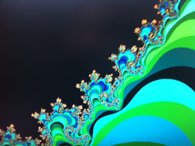

Mandlebrot -1
mandlebrot 1.JPG (118.92 KiB) Viewed 38260 times

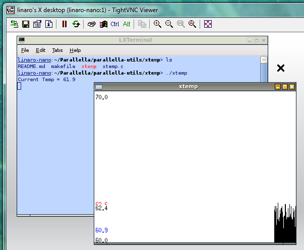

Running the xtemp program from a remote computer.

I have mandlebrot running and it is pretty stunning ! Speed !
