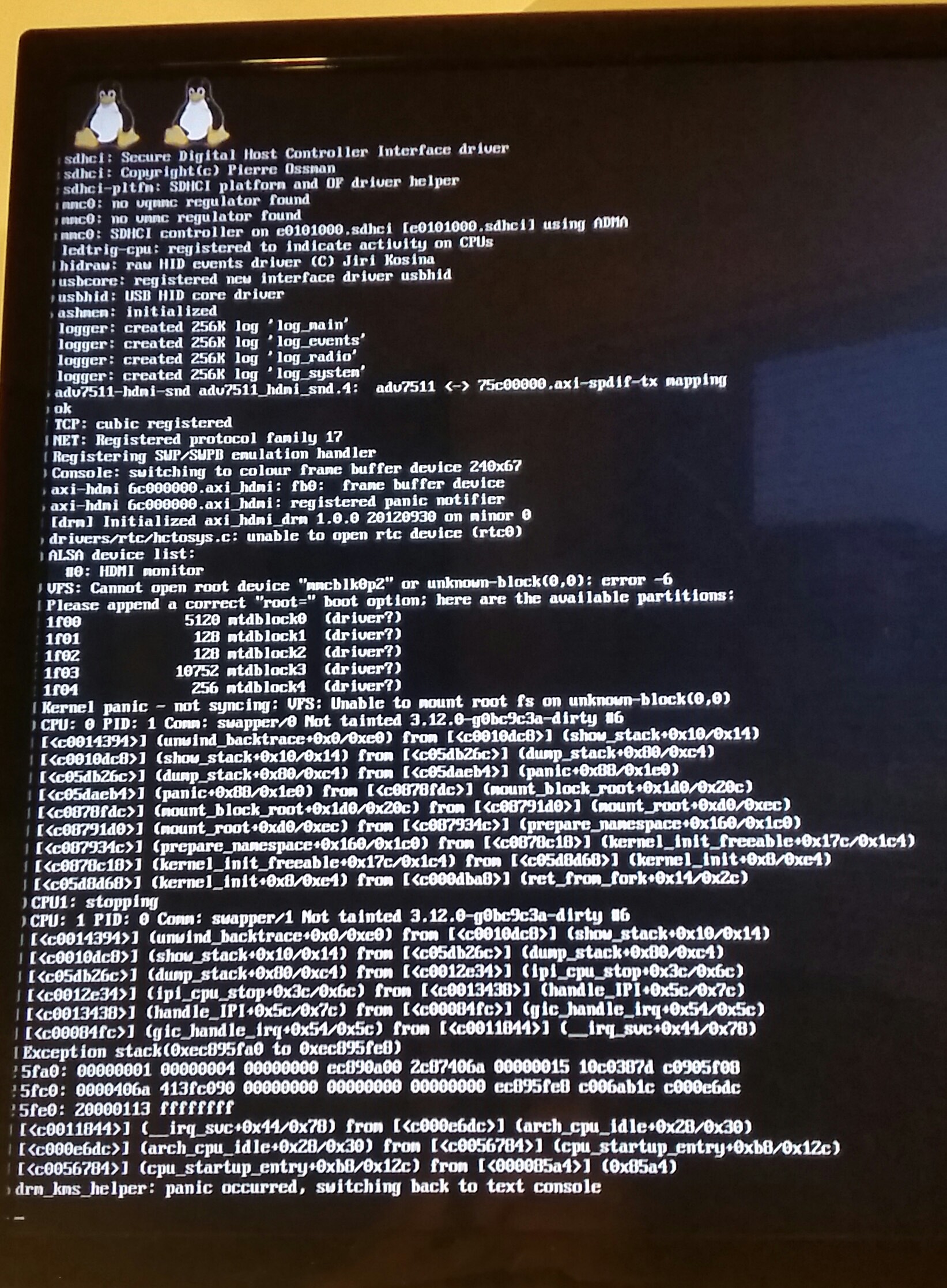

I have been working with the parallella for several months now without an issue. In the last 2 days when I plug in the board and it begins to boot, I receive a kernel panic and the boot sequence apparently stops and never advances after that point.

I have attached a picture of what I get when I attempt to boot. Im starting to think that perhaps this board is dead as the probability of 3 different sd cards all being bad is extremely low.

The kernel can't find the root file system. If you tested multiple SD cards, then this means that your way of writing images is wrong, resulting in wrong SD card content. Describe how you write the images.
