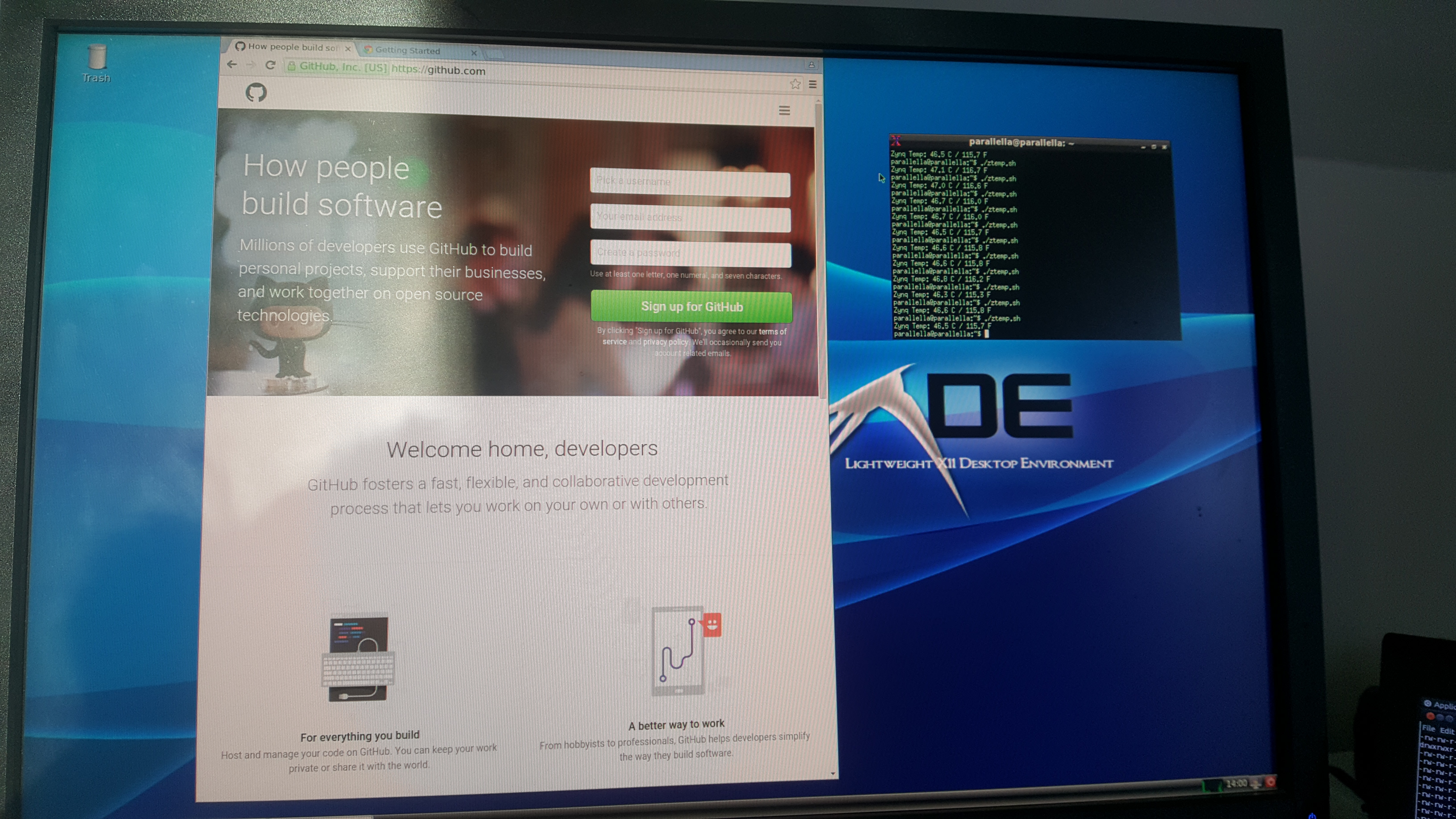

90% of the time, the problem is not burning the SD card correctly (that includes me!)
Just to verify I picked a new HDMI monitor I had and a new P1601 card. No problem with the new image.
Re: Parallella 16 won't boot with 15.04
Postby aolofsson » Tue Dec 13, 2016 2:53 pm
just in case you don't believe me... ;)
(btw, for the record, USB on a randomly sampled board came up 2/2 with new image)
Setup:
DELL monitor, 1920x1200 resoluion (hdmi input)
unpowered micro-->USB dongle
K330 logic vision wireless keyboard/mouse
