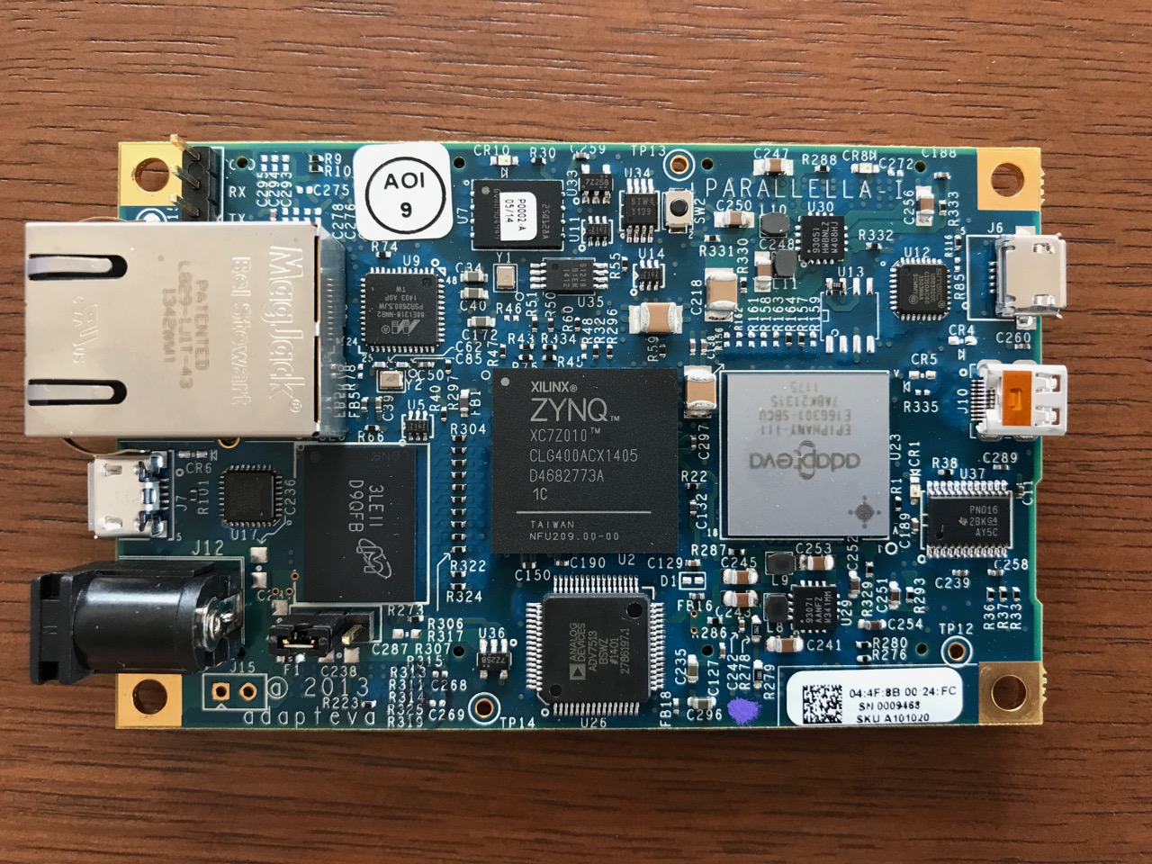

Postby garrekds » Sat Jul 29, 2017 12:33 am
IMG_0282 (3).jpg (461.11 KiB) Viewed 33267 times

From your picture, I see you have the Zynq 7010, but you downloaded the image for the Zynq 7020. Try the other image.

Postby garrekds » Sat Jul 29, 2017 1:02 pm
That is a very simple thing, and I didn't notice it, but that did the trick.
Thank you!
