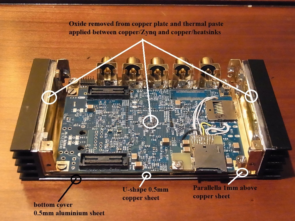

btw. I have been meaning to ask you..do you have some pictures of your mods to the top side of the Paralellla board? What components did you take off and how did you couple the board to the heatsink. Did you use thermal pads to height match?

Thanks for the great explanation. Really enjoying watching you build this!
For the cooling, you might want to do dothermal coupling for some of the smaller chips as well to increase longevity. With the amount of metal you have connected to the board, it's probably not an issue...
In order of importance:
zynq (a must)
epiphany (definitely recommended)
hdmi (would be nice)
9307 (would be nice)
9305 (would be nice)
usb (would be nice)
Re: Audio playback
Postby 9600 » Mon Mar 02, 2015 1:39 pm
That's some pretty resourceful thermal management!
I'm working towards building a Parallella-based tablet, thinking about how best to conduct heat away, and was leaning towards having a U shaped piece of copper bonded to the case and gently pressing down on the Zynq via thermal gap filler. I guess this could be neater / more compact if I removed Ethernet and USB, wiring the pads for the latter to a WLAN dongle. But then I'd prefer to not have to attack the board with a soldering iron.
Any reason you opted for a curved thin copper sheet and paste, instead of thermal gap filler?

Postby aolofsson » Tue Mar 03, 2015 7:46 pm
Wow! Speechless. You are taking smaller, cheaper, faster (better) to a whole new level. :D

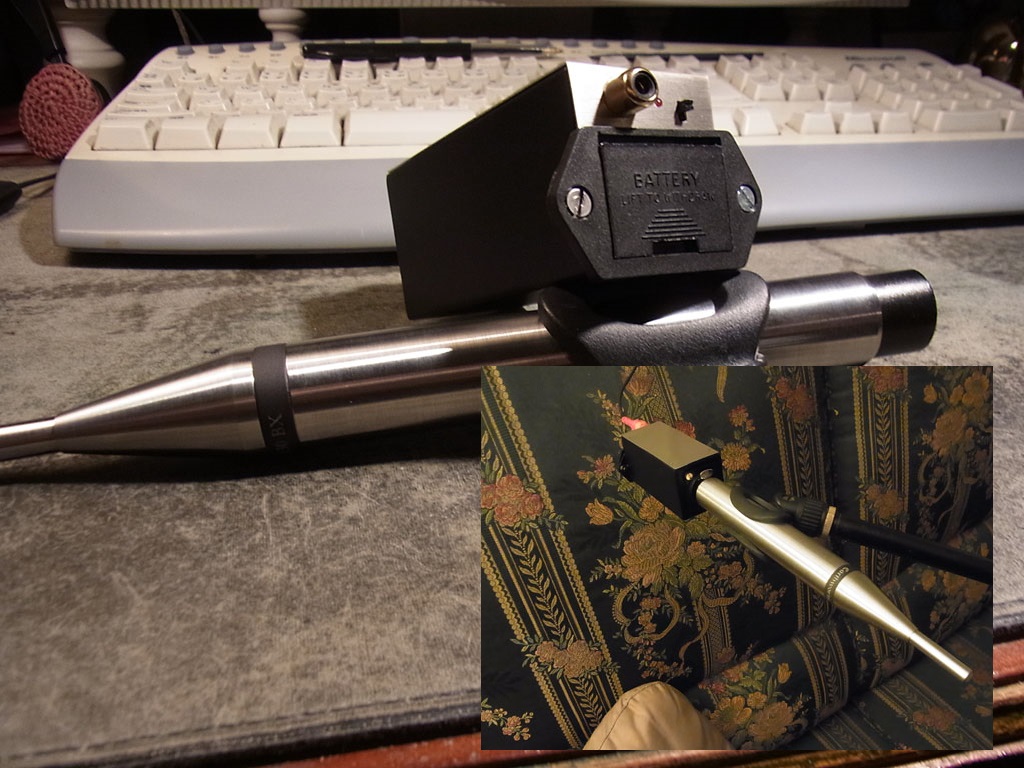

Postby patc » Wed Mar 11, 2015 8:38 pm
ADC#1 - PCM3052A
- started from a 9V battery case
- made a PCB fitting on top
- built the enclosure around the whole thing
next:
- use Mike Field's SPDIF input VHDL code to extract in the Parallella the audio data from the SPDIF stream outputted by the ADC module
- use the same VHDL code I wrote for playback but the other way around: while audio data fills a buffer, the other buffer is DMA'ed into DDR
- then Cortex-A9 writes DDR data to the SD card
- when measurement is completed, run DRC to generate the correction filters
- do the same with ADC#2 Cirrus Logic CS5361 and compare
- enjoy the music...
attached zip file contains:
- the Diptrace schematic + layout
- the 8-bit MCU C source code built with the Silicon Labs IDE coupled to SDCC (both free)
pcm3052a.zip
(128.56 KiB) Downloaded 2016 times
