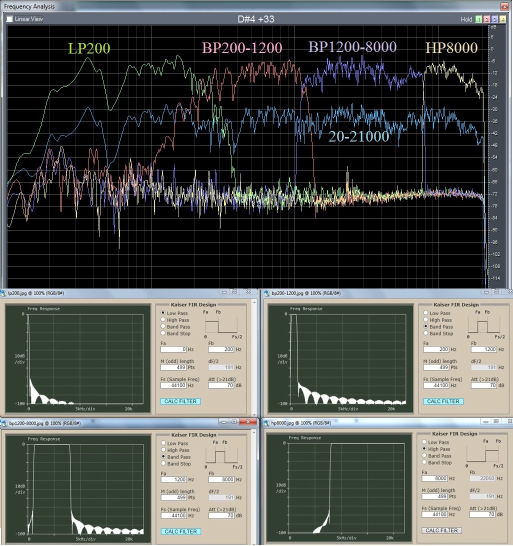

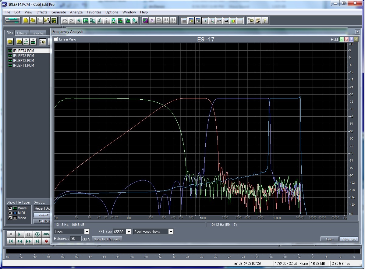

The measurements of my right channel:
- upper part = each amp separately
- light blue below (graphically dragged down a bit to be able to distinguish it) = all 4 amps
The FIR compiler coefficients are calculated from
(I made the slope pretty stiff for horn drivers)
attached are the VHDL source files.

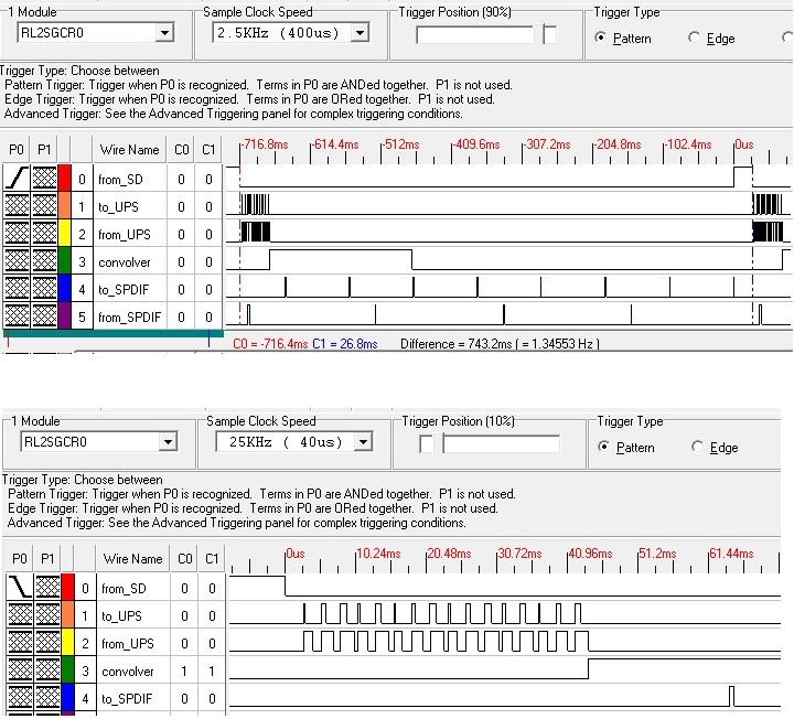

Found this excellent article in Xilinx xcell about an upsampling method:
To easily experiment with it I wrote a simple Excel VBA utility to generate both the coefficients and output equations when given the number of taps and upsampling ratio (zip file below).
Image #1: current workflow
output
- from_SD: read from SD card in chunks of stereo 32K samples @44100 (PS)
- to_UPS: send to BRAM in 16 blocks of stereo 2K samples
- upsample to 88200 (PL)
- from_UPS: send to DDR in 16 blocks of stereo 4K samples @88200
- convolver: digital room correction convolution of stereo 64K samples (PS)
- to_SPDIF: send to BRAM in 8 blocks of stereo 8K samples
- split into 4 with FIR filters (PL)
- send to 4 SPDIF outputs (PL)
64K samples @88200 = 743ms
input
- from_SPDIF: read from SPDIF input (PL)
- send to DDR in 4 blocks of mono 16K samples @88200 (for measurement microphone)
- write to SD card (PS)
all transfers are using DMA and interrupts (double-buffers implemented when timing is critical)

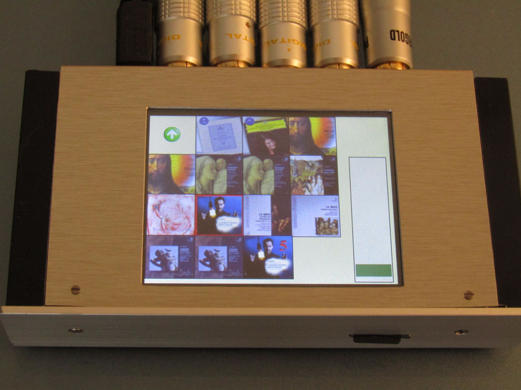

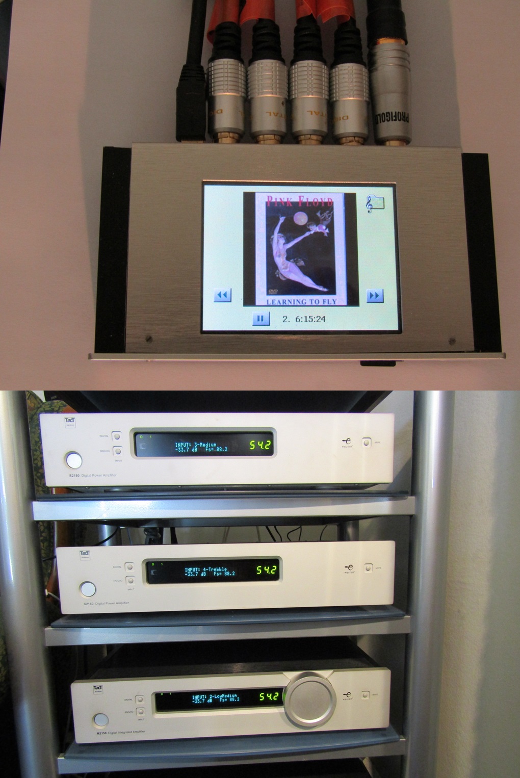

Image #2: "Learning to Fly" with Zynq/Parallella
from left to right on the back panel:
- usb to power the system (and deploy/debug C# app with Visual Studio)
- 4 SPDIF outputs
- 1 SPDIF input (CD player or measurement microphone)

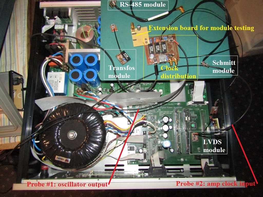

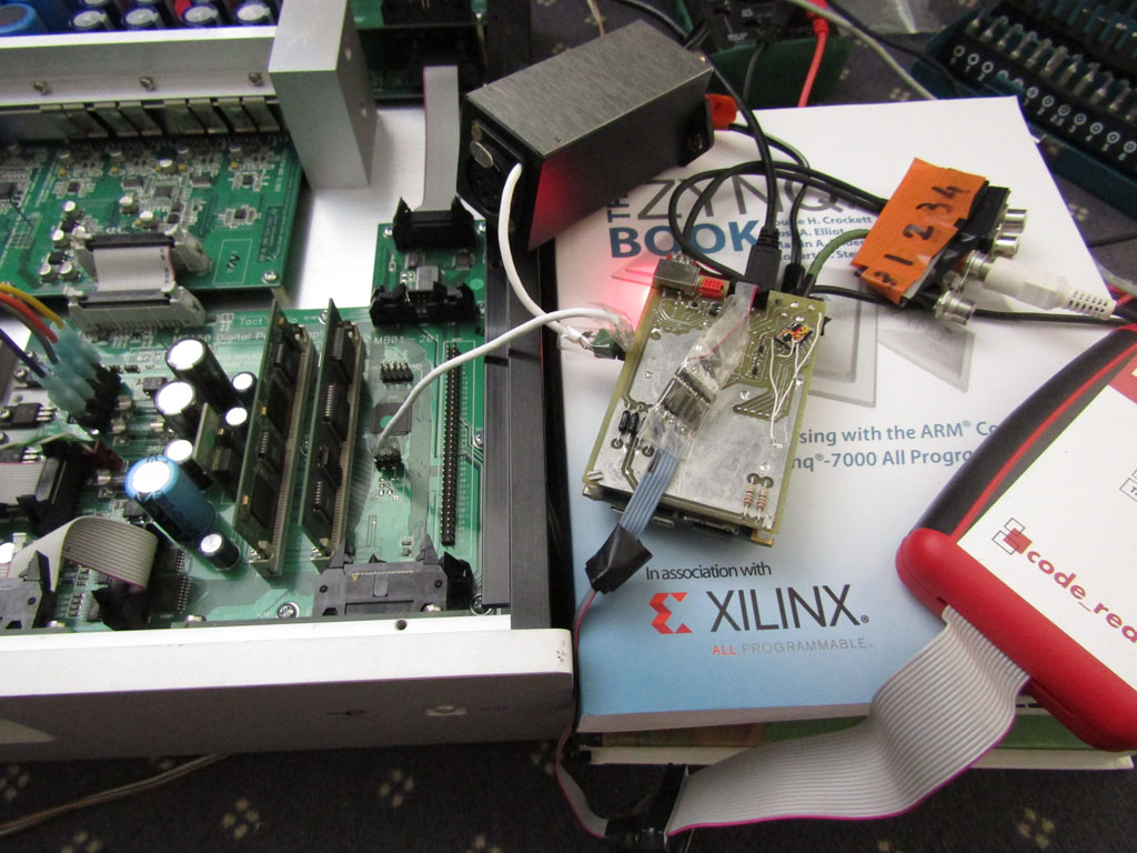

I always wanted to have only one audio clock across the whole digital chain. Many thanks to Christophe, the friend who pointed out that a kind of similar mod has already been done by others and for providing me the guidance to successfully hack my digital amps.
image #1 the playback diagram
image #2 feasibility: the 24.576 MHz original oscillator has been removed from one digital amp and the 22.5792 MHz from the audio playback module is injected instead
image #3 the back panel is getting pretty crowded!

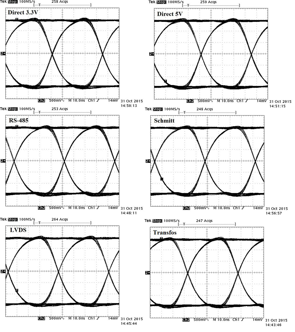

Using the same unique clock across the complete system gives stunning results (in short: lower jitter = much better imaging), so I went for a bit of experimenting.
There are 7 clock connections needed:
- Parallella Zynq (22.5792 MHz)
- measurements microphone (22.5792 MHz)
- 4 x digital amps (22.5792 MHz)
- CD player (22.5792 / 4 * 3 = 16.9344 MHz)
Configurations tested:
1) clock buffer - 50 cm of 50 Ohms coaxial cable - RS-485 receiver
2) clock buffer - 50 cm of 50 Ohms coaxial cable - double Schmitt trigger inverter
3) lvds clock buffer - 50 cm of 100 Ohms shielded twin-coaxial cable - LVDS receiver
4) clock buffer - 10/100 BaseT pulse transformer - 50 cm of 100 Ohms shielded twin-coaxial cable - 10/100 BaseT pulse transformer - RS-485 receiver
All measurements made with a 2x400MHz 100MS/s oscilloscope.
picture #1
the measurement setup where each module is connected in turn to the digital amp clock input (an Altera FPGA)
picture #2
the measurements of each module where channel 1 is the reference clock and channel 2 the clock injected into the amp
picture #3
SPDIF eye pattern
the clock going normally to the amp is fed instead to the Parallella and the oscilloscope channel 2
is hooked to one SPDIF output while the trigger is from channel 1 which is the reference clock
