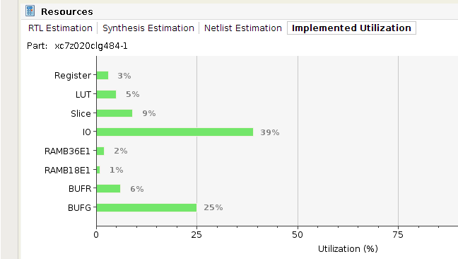

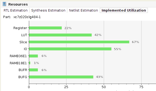

Has anyone idea of how much logic cells are taken by each block in the diagram shown in the platform reference ?
The AXI-Master, slave , the e-link, the HDMI controller, etc .

Postby shodruk » Tue May 07, 2013 8:17 am
HDMI controller is so ... huge. ;)
Can we use Parallella in various FPGA configurations?
For example, No HDMI on Parallella, and we get more space to implement our own circuit.
And if we can control Raspberry Pi from Parallella, we get GPU and HDMI output for Parallella without consuming FPGA slice.

Postby tnt » Tue May 07, 2013 11:29 am
The board has an external PHY. you just need to push the RGB data bits in //
