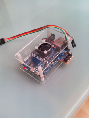

Postby ESI » Fri Jun 20, 2014 11:53 pm
Hi there,
JTAG works now, so no excuses for me not to start debugging, updating etc...
see attached pictures.
My test was:
>xmd
XMD> connect arm hw
then I saw the two taps of zynq...
and was happy for ever after....
