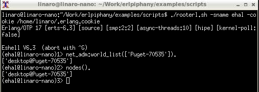

An Erlang node can be started from the command line with arguments that define the node name and the cookie value or location (if the cookie is not specified, then the node looks for the file .erlang.cookie in your home directory on startup). The authorization cookie itself is nothing more than a character sequence. The commands below show one way of starting a local node, establishing communication with other nodes, then logging into a remote node.
On the Parallella board…
ehal_start

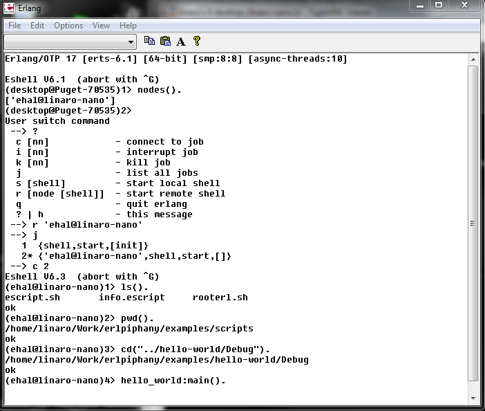

And on the desktop…
remote_shell
Typing ^G brings up the shell menu and the ‘r’ command can be used to create a shell on the remote Parallella node, as shown with the ‘j’ (jobs) command. You can then connect to the remote shell and issue commands just as if you were logged in locally on the Parallella board, as illustrated by the ls() and pwd() commands.
The nodename@hostname tag in the command prompt helps you keep track of which node you are logged into. Once remotely logged into the Erlang node started on the Parallella board, we can change to the hello-world directory and run the hello world example directly.
remote_run

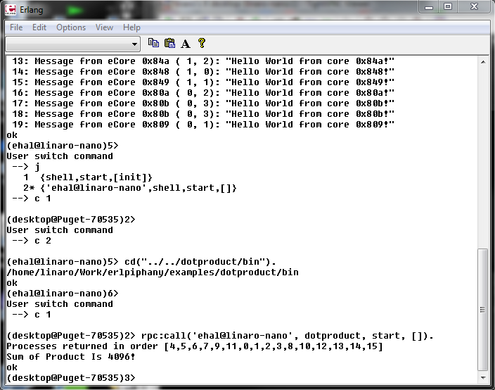

The Erlang rpc (remote procedure call) module allows one to invoke Erlang functions without the need for a remote shell. This is one way that a coordinating application on your workstation could spawn processes on one or more Parallella boards. Here for example is how we might invoke the hello_world example program from an Erlang node started in the scripts directory as before.
remote_call
In the above sequence we connected to the Parallella node in order to change directory to the dotproduct example. After switching back to the local node, the rpc:call command is used to invoke the start function exported by the Erlang dotproduct module. This particular code example spawns a process per Epiphany core, with each process loading and running a program, then sending the result in a message back to the parent process.
