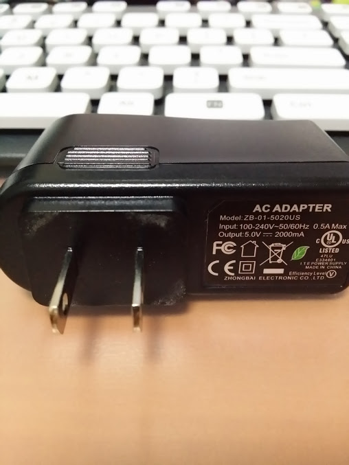

Can you please confirm the model number/type of the power supply you are using.
Re: rma
Postby jiajun » Mon Mar 10, 2014 12:47 pm
attached the photo of the power supply.
20140310_204443 (1).jpg (51.38 KiB) Viewed 16168 times

The PSU looks like it is to spec, but we ask because we have seen many PSU's that do not live up to the specifications and cause issues. Try another supply if you have one.

I had tried 2 different power supplies but did not post the pictures because I had returned them to my friend. The situation was the same with that 2 power supplies.
There was no sign of the board booting. I had serial connected as described. Nothing appears. Nothing on hdmi either. The green led does not stay on either. It flashes continuously.
