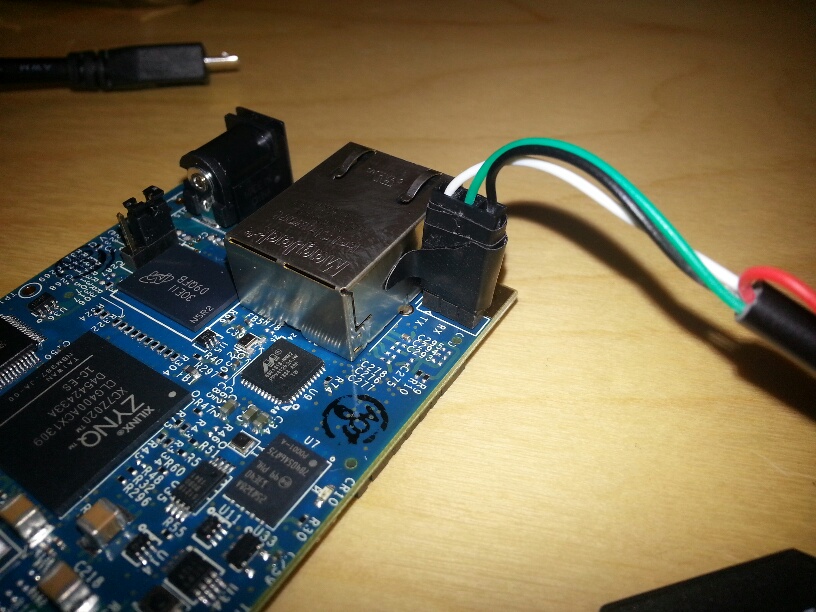

I have a few questions regarding the serial cable.
1 ) Do I connect the serial cable to the pins next to the Ethernet input.
2 ) From outside to inside. are the colors black, green, white.
3 ) I confused on how to get the information. I don't know how to configure the applications that i have found to listen to the cable.

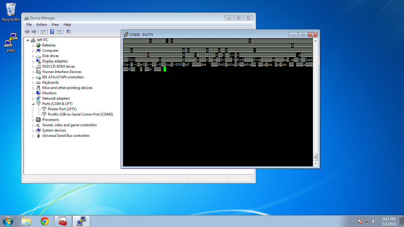

Postby jeff.seibert » Thu May 01, 2014 9:44 pm
Hello,
I have tried a new SD and still no luck. I have the serial cable now, but I can't figure out to get user it properly. I have tried minicom, but I don't think I'm setting the configuration correctly. Any of the application that I've tried either give me nothing or random symbols. One thing that I notices is that while trying to get the serial cable to work the board would randomly turn off. I have no idea. Could someone show me how to setup minicom or a similar application on Ubuntu.
Thank you
jeff.seibert
Posts: 15
Re: Parallella Board not bootin
Postby gceline » Thu May 01, 2014 9:51 pm
The board is marked with the Tx/Rx and GND for the pins
Try this link for more info: http://elinux.org/Parallella_UART_Connection
If you use Putty.exe - when you open the app, select the Serial option on the Session tab.
The only complexity is working out which com port the USB is on - this usually shows up when you plug it in in the system messages.
set the com port (COM4) and the Speed (115200) and click open - this should open a terminal window and hitting enter will give you a prompt. (if the board is working)
If not - reset the board and see what messages come up.
If you boot the board without the SD card, the terminal will show the boot messages followed by the zynq-uboot> prompt.
If you use an SD card you should get a bevvy of start up messages starting with loading the parallella.bit.bin file, then loading the uImage, finally followed by the root@linaro-nano:~# prompt
Graham

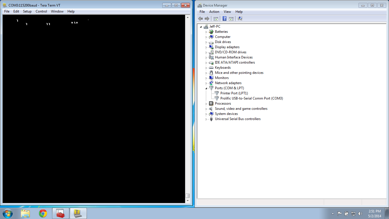

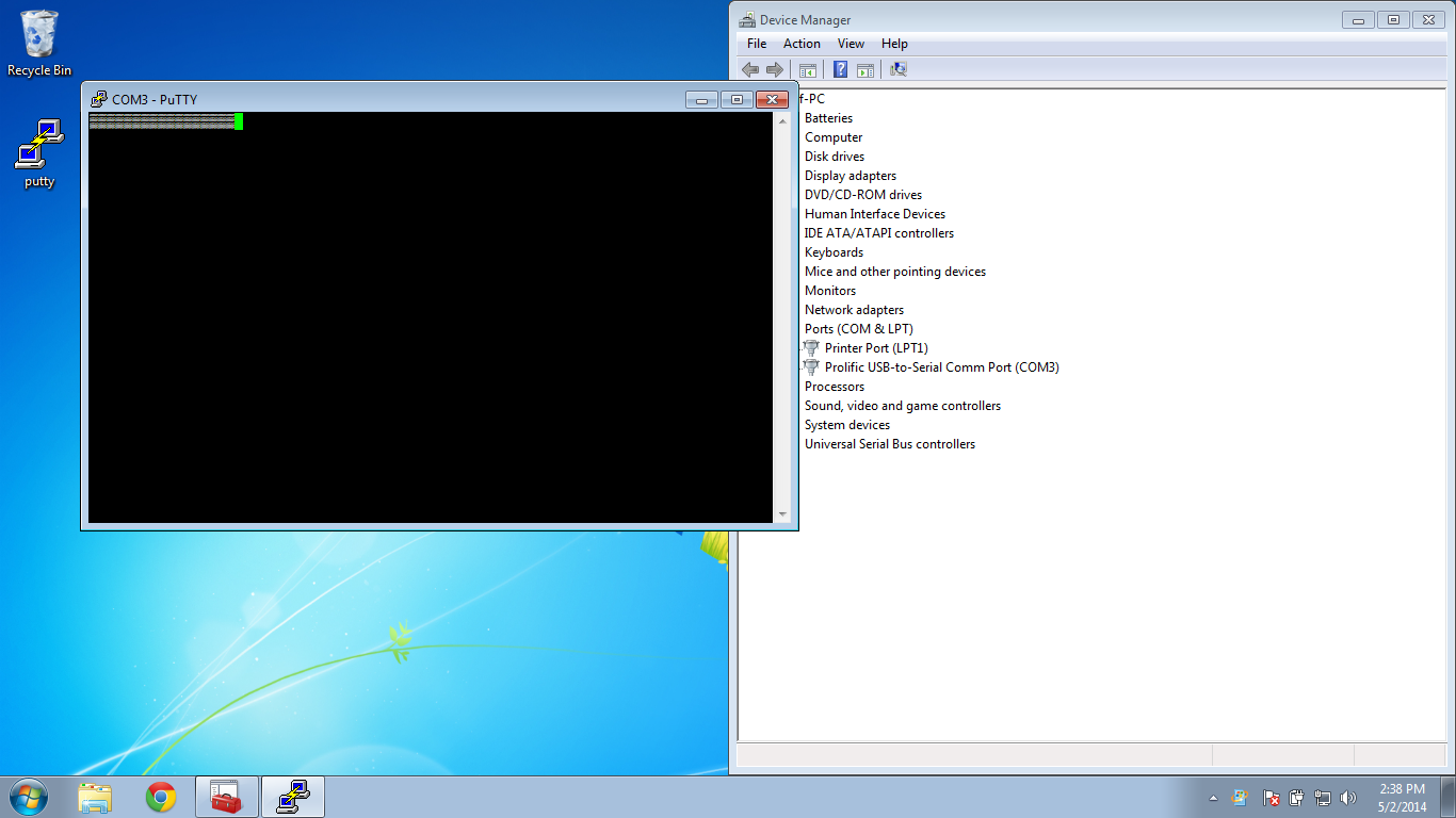

Postby jeff.seibert » Fri May 02, 2014 12:57 am
Windows 7 64 bit.png (361.87 KiB) Viewed 24065 times

Postby gceline » Fri May 02, 2014 3:10 pm
mine looks exactly the same!!! - if I leave it at the default speed of 9600 baud
If I set the terminal to have the correct settings, it works great - 115200 baud
Graham
