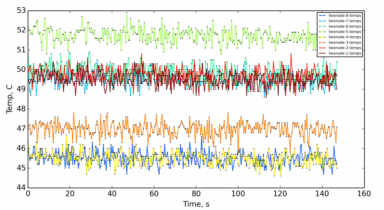

I promised I would get some data later tonight regarding heat distribution on my cluster setup. Here's a pretty graph.
The graph shows the temperature of each board in the stack, with the position in the legend corresponding to the vertical position in the stack. The variation in temperatures generally accompanies different positions that I tried, with each position getting about 30 seconds to normalize. I'll have a more thorough setup in later days this week.
I'm not an engineer, but it looks like for stacked boards the temperature variation depends pretty heavily on board position in the stack and relative position of the fans. This should be pretty obvious (like, really obvious), but the graph somewhat quantifies this.

@optimaler: I just love charts! And it looks like you have all 8 boards linked up now.
The stability of a Parallella seems to depend, in part, on keeping temperatures stable and low. The differences shown here for each board are significant - and a tad high - and it shows that this is an important project. Go for it!!!
You say you tried a few things, such as different standoffs, positions of the fans, etc. Hopefully - after you've had some sleep - you'll post a few more pictures with the results.
Your picture at shows two fans stacked vertically. Lots of air pushed - but inefficently.

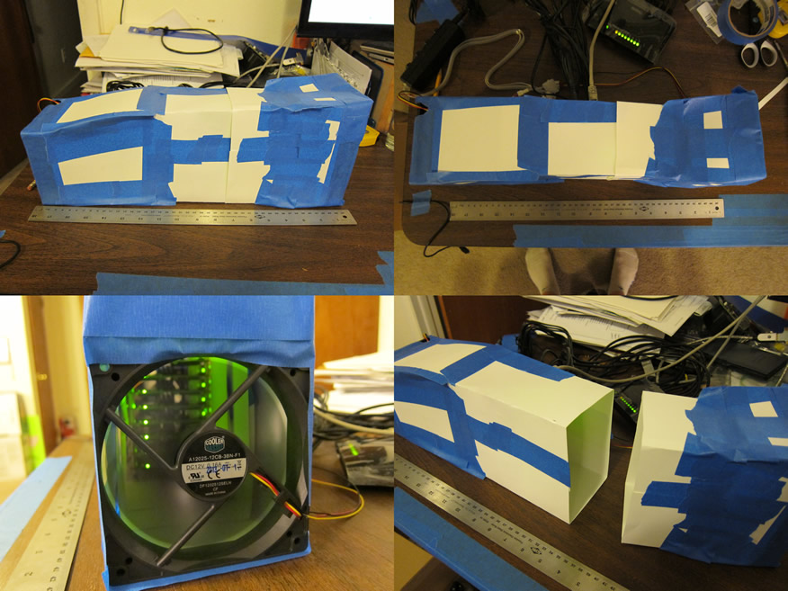

I built a cardstock case to direct the flow of air more cleanly, shown below. The setup is push/pull; I tried to block as many openings as possible. The end with the pulling fan is detachable so I can access the reset buttons (I am still having grief with eth0 not coming up properly).

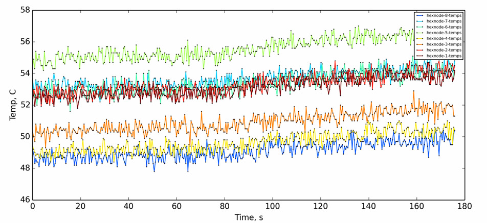

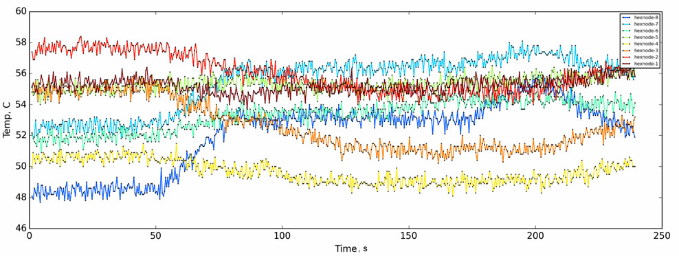

The graph below shows the temperatures with and without the pull fan attached to the enclosure. The transition occurs around 60 s, leveling off around 120 (as best I can tell). Like in my original post, the vertical board position corresponds to vertical position in the legend.
My observations:
1) The enclosure makes the cooling more consistent, and for the most part drops the temps about 2 deg C.
2) Using push/pull instead of just push with the enclosure gives approximately 2 deg C additional drop.
3) I wondered why board 5 was running hot compared to the other boards. The best hypothesis I can come up with is that the chip runs slightly hot compared to the others; I examined the placement of the heatsinks to see if there was any observable difference.

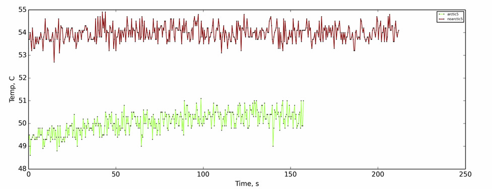

So I conveniently have some Artic 5 silver compound sitting around, so I decided to see what the temperature difference between the two might be. I scraped off the tin foil, cleaned off the heatsinks with 70% isopropyl, and applied artic silver. I put single board in my enclosure, with and without Arctic 5 applied. Here are the results:
As you can see, you can decrease the temperature by about 4 C by using proper thermal compound, versus weird silver foil stuff. I don't necessarily endorse this modification of the setup, but honestly it makes a non-trivial difference. Maybe someone in the Adapteva crew can endorse the use of thermal compounds so everyone can enjoy lower (and safer) temps?

No surprise that properly applied Arctic silver is more efficient than the adhesive thermal tape, but thanks for the example and data. I'd planned on doing much the same.
The issue is how to safely and securely fix the heatsink when there are no holes/clips on the board. Card Stock won't help here, I'm afraid. ;)
