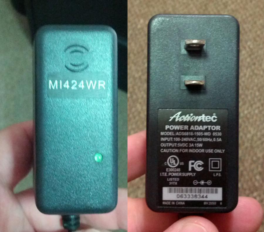

I am also getting a blinking green light on the board as well as on the power supply which is the same as the pictured above (the one sent with parallella accessory package marked MI424WR). The light on the PS blinks as well and I tested the outlet and it works fine. I hope it isn't the board as I took precautions against ESD during unpacking. I am going to try another PS and see if that fixes the issue.

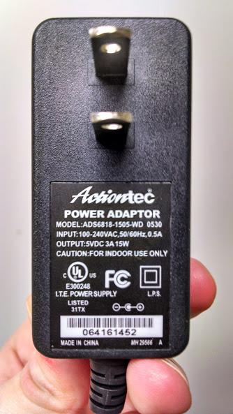

I believe I'm having a similar issue. The power unit was one that was sent to me by Adapteva.
When I plug in my parallela it is initially a solid green but then it starts blinking. The green light on the board above 'A', the green light on the power supply, and the ethernet link light all blink in synchrony.
It's the same if it's plugged into the wall or a powerstrip.
If I plug in a different power source I can see the login screen - and I can ssh into the device. So - I think this means that it's a issue with the power supply.
I've attached a picture of the device problematic device.

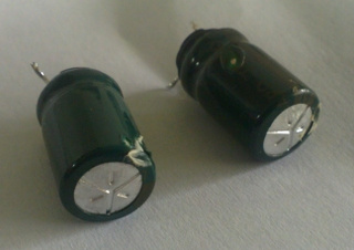

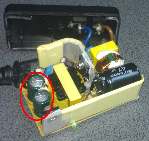

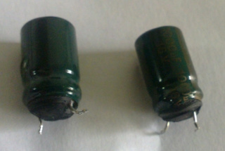

I had exactly the same issue as svidgen. The PSU is exactly the same, from the Parallella Accessories Kit. After disassembling the PSU, the issue was clear: the two filter capacitors had bulged top and bottom.
PSU
The bulged capacitors:
Capacitors bulged top
Capacitors bulged bottom
Replacing those two 1000uF 16V capacitors solved the issue. The Parallella board works well with it.

I can confirm with bszente. I opened up mine also and those 2 capacitors are also bulging. Gonna order some caps to replace them.
