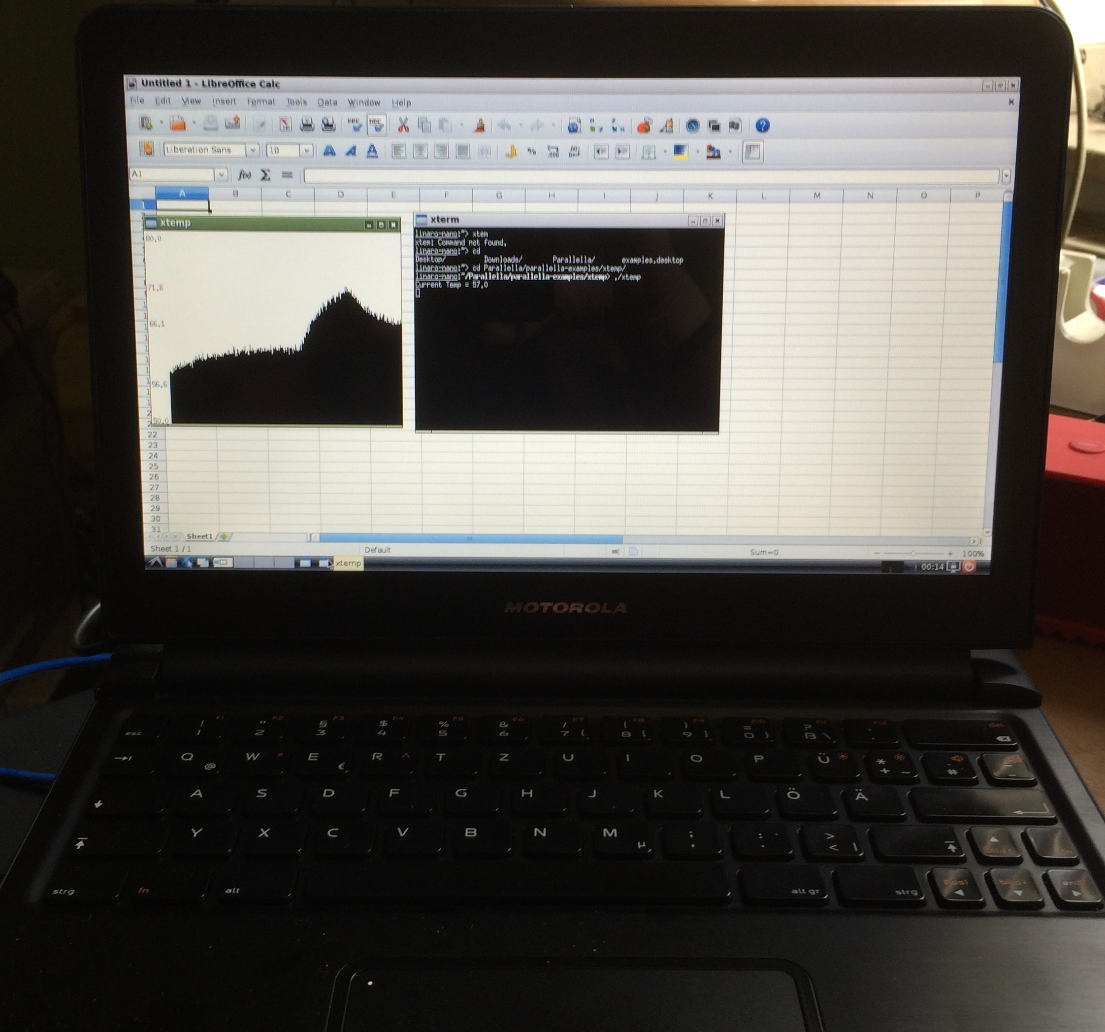

Hi there, just want to show my portable Parallela, powered and hosted by the Motorola Lapdock, which i grabbed for my raspberry (60€ ca.)
Power is provided from the Lapdock Battery via USB, HDMI out to Lapdock HDMI in (Micro male to Micro Female using adapters),
Keyboard and Trackpad from the lap dock are working fine.
Also the resolution and anything else recognized right off using ubuntu-lxde-14.03.06-rootfs.tar.gz.
As cooling fan i am using some old 12V fan powered by a 9V battery.
On the picture you can see a peak, for which i removed the fan for some time (2mins ca.) above 70 the the color changed to yellow, nice feature

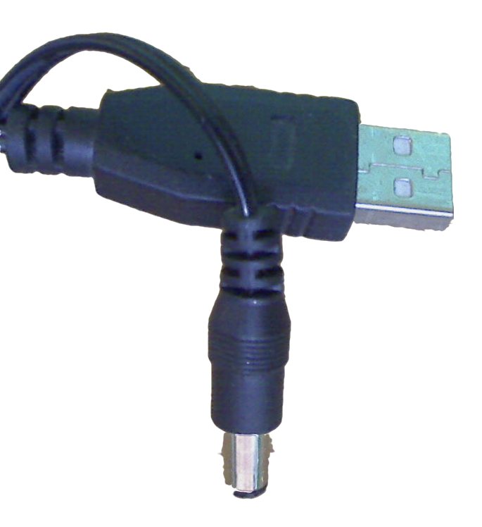

Well as you might see on the pics, i am powering the board seperately with a second USB to Power Cable from one of the LapDock USB Ports.
This way solved the problem for using mouse and keyboard (for me)
