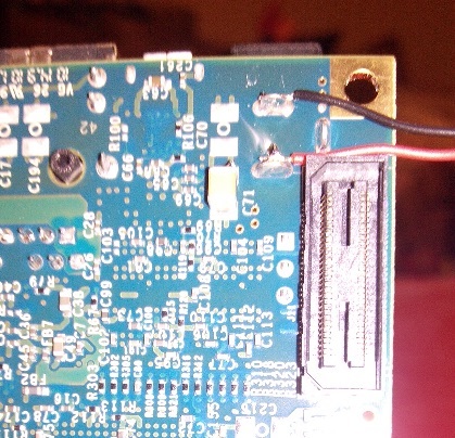

Postby hamster » Sat May 17, 2014 9:35 am
Rather than using the clustering jumper I paralleled the fan over the barrel jack. Seemed to work fine even though I used my leaded solder...
My fan connections

Postby FHuettig » Sun May 18, 2014 6:54 pm
Hamster, that's an excellent place to make the connection! Those through-hole pins are big & sturdy and it's got good clearance from other signals apart from that one big cap. I'm going to link to this posting from the topic.

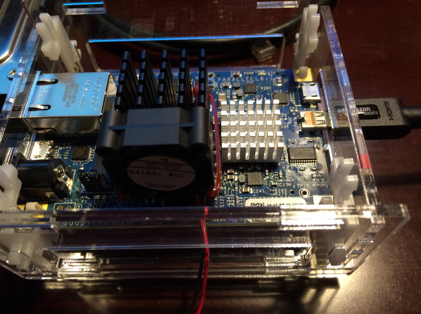

Postby imwmh » Tue Jun 24, 2014 2:05 am

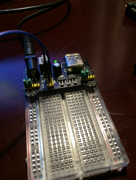

My solution shown in the pics, which is binding a fan to the heatsink. Due to the both sizes of the hehe atsink and the fan, it's have to be running without the lid on.The power supply for the fan is a standalnoe one, it steps the input voltage of 5v down to 3.3v to drive the fan.
A standalone power supply and step-down board.
A fan bound to the heatsink.
