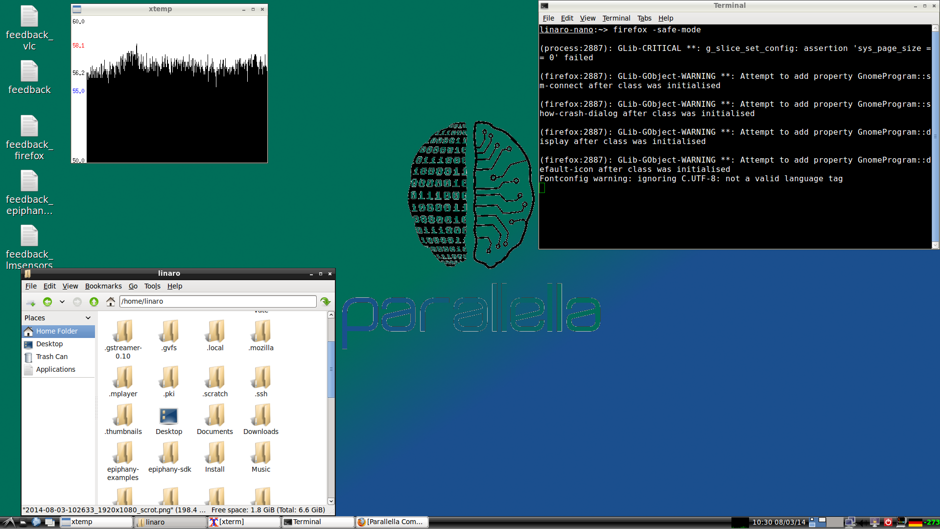

Postby adexmont » Sun Aug 03, 2014 10:37 am
a simple (and awful) mod of the background made with parallella gimp.
posted with parallella on parallella site just to get rid of the firefox stability problem. (i´m now in safe mode that let me do longer session without crashing)
+a screenshot of what i was able to get in my attempting to setting up my os ambient.
i had some trouble with vlc that won´t show any video, just crashed using all arm cpu and need to kill -s 9 PID to regqain controll of the machine.
aisleriot is working too
screenshot of a not skilled user
relaxing background
