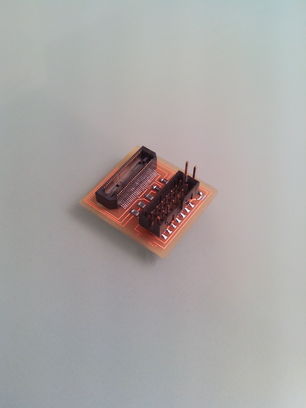

The most urgent thing I need, is a JTAG interface.
I have some samples of the samtec connector, so I decided to use one to connect JTAG.
I designed a small pcb, only covering the PEC-Power.
please have a look and tell me if something could be improved. (eagle files attached)
some explanation:
I will solder the pcb by hand (samtec connect probably under microscope) So I enlarge the smd-pad for the samtec connector for better soldering.
The Xilinx connector is not tested in size right now. The resisitors are 0805 and the pads are big enough to solder by hand.
ParallellaJTAG.tar.gz
(36.53 KiB) Downloaded 1710 times

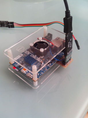

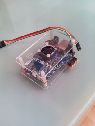

Postby ESI » Fri Jun 20, 2014 11:53 pm
Hi there,
JTAG works now, so no excuses for me not to start debugging, updating etc...
see attached pictures.
My test was:
>xmd
XMD> connect arm hw
then I saw the two taps of zynq...
and was happy for ever after....
ESI
