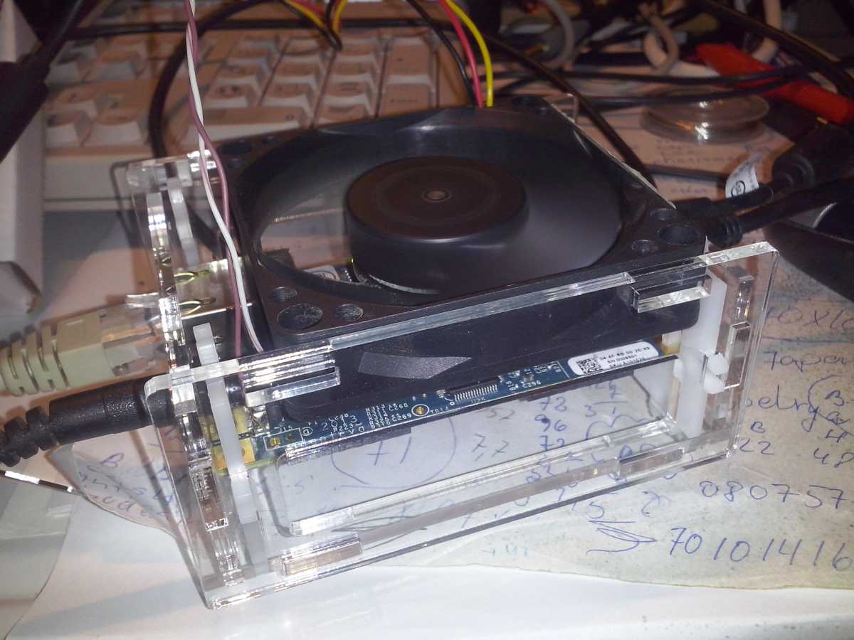

I have tried this out tonight. Downloaded all new bitfiles and Ubuntu release and dd'ed to a new partition
I deleted /etc/udev/rules.d/70-persistent etc file with no effect.
My board is hanging at the following state of the boot.
logger: created 256K log 'log_system'
TCP: cubic registered
NET: Registered protocol family 17
Registering SWP/SWPB emulation handler
drivers/rtc/hctosys.c: unable to open rtc device (rtc0)
ALSA device list:
No soundcards found.
EXT4-fs (mmcblk0p2): recovery complete
EXT4-fs (mmcblk0p2): mounted filesystem with ordered data mode. Opts: (null)
VFS: Mounted root (ext4 filesystem) on device 179:2.
Freeing unused kernel memory: 188K (c0878000 - c08a7000)
Mount failed for selinuxfs on /sys/fs/selinux: No such file or directory
init: plymouth-upstart-bridge main process (884) terminated with status 1
�F�W�W�XPocess ended, respawning
init: plymouth-upstart-bridge main process (893) terminated with status 1
0ility groupdded 8 pages/cpu @c160600init: plymouth-upstart-bridge main process (896) terminated with status 1
Q�"F��G��}�Lvͤ٦�$�

@timbat, which FPGA bitstream and kernel are you using?

Hi Tim,
Can you try using the HDMI kernel and FPGA bitstream.
