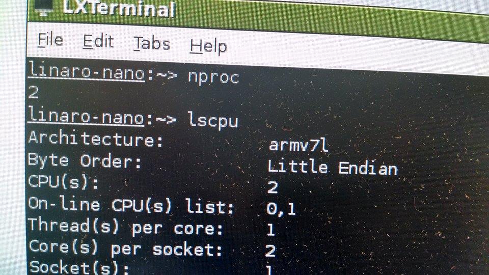

Hi everyone,
I was running some benchmarks on the Parallella 16 core board and I was getting some weird results. I used the "nproc" command (described here: http://www.cyberciti.biz/faq/linux-get- ... e-command/) to see how many processing units are available. I was expecting to see 16, but instead 2 was outputted. I attached a picture of the rest of the details. I was wondering if anyone came across this problem or knows what to do to fix it?

Shouldn't that output just show the ARM cores ?

Postby baseballguy » Thu Jul 24, 2014 1:20 pm
Sorry, I'm pretty new to parallel programming and stuff, but is it possible to run these benchmarks (PARSEC) on the Epiphany cores instead of the ARM cores?

Postby baseballguy » Thu Jul 24, 2014 1:42 pm
Basically from what I understand, the CPU usage will indicate how many cores are running. For example, if 8 cores really are running, then the CPU usage would be 800%. If 4 cores are running , it would be at 400%. However, all of the PARSEC programs maxed out at 200% showing that only 2 cores(the ARM) are running.
Is my understanding correct or am I missing something?

Postby sebraa » Tue Jul 29, 2014 5:56 pm
If you select gcc-pthreads, your benchmark is compiled to use POSIX threads using the ARM cores. So it will parallelize, just not on the Epiphany. :-)
The host application is responsible for loading the programs into the Epiphany cores, communicate with them and make use of the data it receives. It is compiled with the host compiler (gcc) and runs on the host (ARM).
Then, you have the Epiphany applications, which are doing the heavy lifting. They are compiled with the Epiphany compiler (e-gcc), which is part of the SDK.
You cannot take a ready-made program, compile it with the defaults and expect it to use your Epiphany (unless it is written for or specifically supports it). It might work with OpenCL, but I haven't looked at it yet. So unless your application supports Epiphany or OpenCL, you need to port it yourself first.
