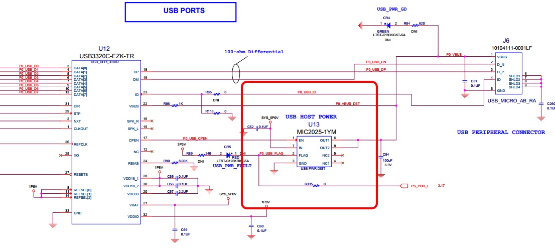

I use S-link SL-U90 USB hub but it didn't work. Am I supposed to use a powered USB hub? By the way, USER LED CR10 and HDMI work properly.
I also noticed that USB_PWR_GD CR4 is OFF.
Is it possible that the board is damaged?
The board schematic says that P0_VBUS is output from MIC2025-1YM.
Please see the attached file.
