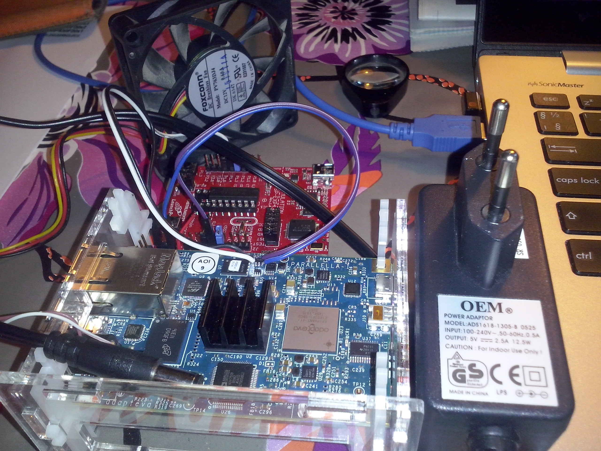

In my case of the 7010 board without mounted U13 chip, usb regularly fails at startup, maybe 50 % chance, i don't know.
If I reset with the button, USB always works, but of course this can upset the OS.
I've made a de-bounced startup circuit with the supplied wall wart, which seems to increase the chance of a startup with USB.
I don't think HDMI or not made a difference, I used the latest Linux and FPGA of a couple of months ago.
I've used various USB units, a long extension cable improved startup chance (but not near 100%), and conrad switchable hub.
T.

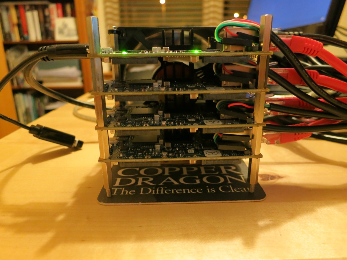

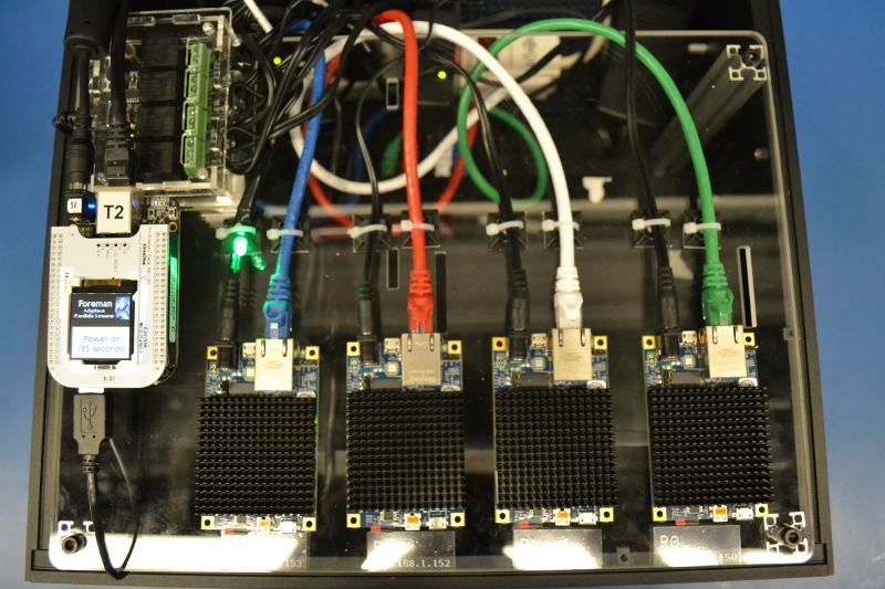

Thanks for the detailed feedback. I noticed in the picture that only one board had USB/HDMI connected. Under what conditions were the 10 tries done for board 1-4? Were all of them connected to USB dongles at power on? Your results fit reasonably well with our data if board 4 is the top one and you only had that USB cable connected. If this was not the case, then we are back to head scratching...
