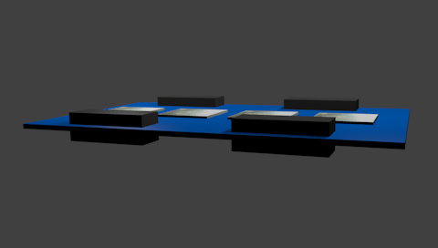

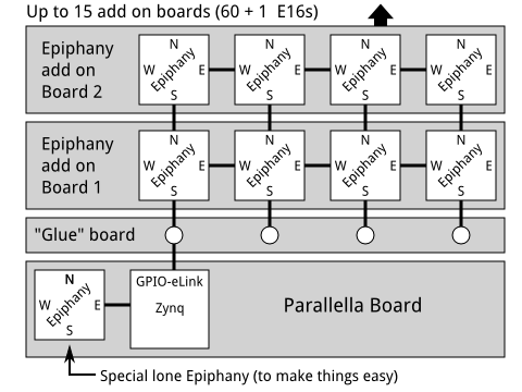

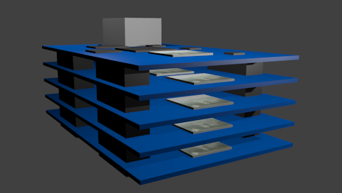

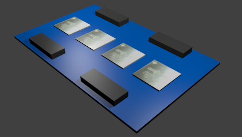

Mark,
Yes, samtec connectors are very expensive. :cry:
But I think we can use BSH-120 instead of 4x BSH-030 to save some money.
BSH-120 $9.66
http://www.digikey.com/product-detail/e ... ND/1975817
BTH-120 $9.86
http://www.digikey.com/product-detail/e ... ND/1975824
$19.52 per add-on board
BSH-030 $5.89
http://www.digikey.com/product-detail/e ... ND/2619990
BTH-030 $6.00(maybe)
x4
$47.56 per add-on board
Andrew,
Thanks! The third eLink would be very useful.
Tim,
Yes, we can add the Epiphany on Parallella to the eLink network, but I thought that implementing eLink router on FPGA can be a nightmare, so I thought it's better to let it isolate.
Andreas,
Great! I expect that doubles something...

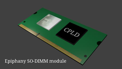

Postby shodruk » Tue Apr 08, 2014 4:53 pm
Epiphany SO-DIMM module inspired by
Re: Ideas for daughter cards?
Postby aolofsson » Tue Apr 08, 2014 5:39 pm
Nice :D
Using the SODIMM concept is well known and there are quite a few boards out there already with this form factor. Here's one from Switzerland that uses the Zynq:
http://www.enclustra.com/en/products/fp ... /mars-ax3/
Not sure if this is our highest priority, but the Parallella is open source so if there is a market for this type of SODIMM I am sure somebody will build one. :D
