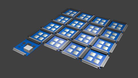

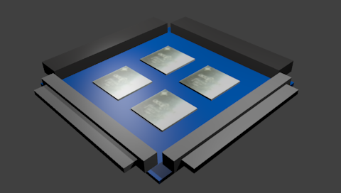

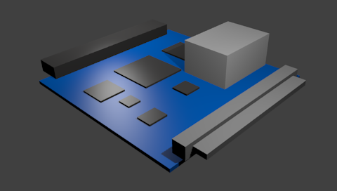

Postby shodruk » Fri Oct 17, 2014 7:55 pm
Very interesting!
Is that like this?
Epiphany Module
Zynq Module
Connected Modules

Postby shodruk » Sun Oct 19, 2014 4:25 pm
Nice CGs!
Yes, I was inspired by your idea.
I think it is necessary for Epiphany to be implemented as such a scalable modular boards because Zynq is too "luxurious" to drive only one Epiphany.
