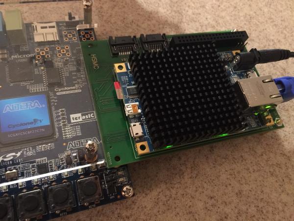

I made a DIY HSMC Paralella carrier to connect one of the eLink interfaces to an Altera Cyclone V FPGA.
I got the mating connectors directly from Samtec, HSMC Samtec from DigiKey, PCBs made by Bay Area Circuits (designed in DipTrace). I got a desktop stencil for the top layer from BAC to apply solder paste and ran it in a T-962A reflow oven. The bottom HSMC connector I carefully applied paste by hand and did a second reflow pass. This was actually my first project with the oven, and was surprised how well it turned out. It did take a few attempts to get it right.
I've been working on some Verilog to communicate with the Epiphany. I'm fairly new to HDL, so any pointers would be great! I currently have a basic receiver/aligner working that's up on GtHub https://github.com/wtfuzz/epiphany_altera
I seem to be updating and checking twitter more these days instead of forums, so if anyone's interesting in following along: @inet_ntoa

This is currently just for fun, with the goal of finding new applications. I'm interested in what capabilities adding I/O flexibility to the Epiphany will bring. I realize some of this exists with the Zynq, but I've already become somewhat familiar with Alteras tools. The workflow seems easier as well with an external FPGA as you can reprogram the target without disrupting the Linux host on the Zynq.
This C5G has 256MB of LPDDR2, hdmi, 24 bit audio, usb uart, some GPIO and a number of 3.125gbit transceivers. My main interest is writing modules that could be directly interfaced via eLink. For example SGMII gige PHYs connected to the transceivers, with MACs in the FPGA that could be setup via epiphany cores and do packet DMA into the mesh for parallell packet processing.
I've been envisioning the model of tiny performant CPUs working together for a while rather than the current few big core model. I think to support this model the peripheral hardware needs to be rethought as well. In the Ethernet case, imagine the hardware filling many tiny rings instead of one global RX ring for example, eliminating traditional locking of shared buffers.
