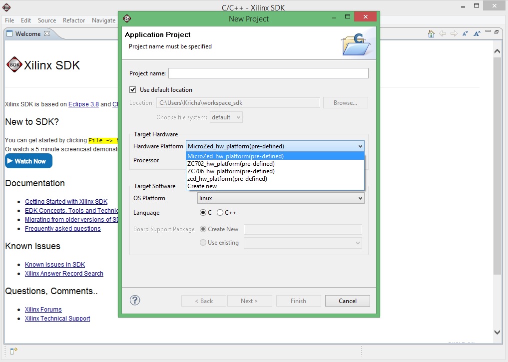

Hello every one
First of all , i wanna let you know that i'm new with all this stuff :geek:
I'm trying to master the Parallella with all of its options, so i decide to start with programming the ARM and then to program both ARM and epiphany at the same time and after that i will bring some co-design (Hardware, ARM, Epiphany).
Should i use Xilinx SDK to program the ARM cores, if so :
- the program will run under Ubuntu in ARM??
- What should i select in Hardware platform (i'm using parallella 7020)
Xilinx SDK
Regards
zodane
Posts: 26
Joined: Mon Nov 10, 2014 8:45 pm
Re: Parallella SDK
Postby sebraa » Mon Feb 16, 2015 5:22 pm
To program the ARM cores, you can use the installed compiler (gcc) on the Parallella.
It will generate programs which run inside the Ubuntu on the ARM cores.
To program the Epiphany, you should use the eSDK (e-gcc) installed on the Parallella.
It will generate programs which run inside the Epiphany cores, but you also need a host program running on the ARM cores.
Only if you want to do hardware design for the FPGA, you need to touch Xilinx tools. Until then, ignore them.
