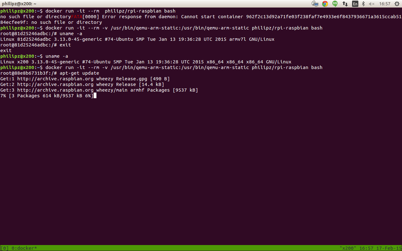

I have make this testing on RPi. Maybe it also works on Parallella.
Run RPi Raspbian by Docker on X86 Linux, not QEMU ~~~
sudo apt-get install qemu-user-static
sudo docker run -it --rm -v /usr/bin/qemu-arm-static:/usr/bin/qemu-arm-static philipz/rpi-raspbian bash

I've never used qemu before so I'm not sure what your screenshot shows. Are you running a RPi emulator inside a Docker container? That sounds extremely cool for testing RPi code automatically. Do you know if anyone has attempted a qemu for the Parallella?
