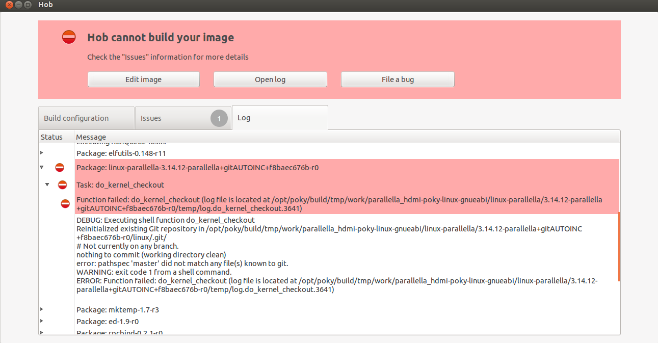

Yocto project shows and error building the image. The error is shown on the attachment. I hope someone could give me an idea about what can be the problem.

I attach a screenshoot of the hob error

I have not seen this error before. I suspect that you have not selected the branch to use.
One solution might be to use my complete environment https://github.com/peteasa/parallella-yoctobuild where I select the branch and commit, fix any problems and then submit this to github.
Another solution would be to try the latest dizzy branch in meta-xilinx and dizzy branch in poky git://git.yoctoproject.org/poky.git. Then if there are any recipes not present in poky that you need from openembedded-core pull these in from http://cgit.openembedded.org/meta-openembedded/. As all you talk about in the post is the kernel then I think that you will find that meta-xilinx, poky with meta-parallella will give you what you want and you do not need openembedded-core.
Here is the thread on this forum where yocto is being discussed... viewtopic.php?f=9&t=414&hilit=yocto
