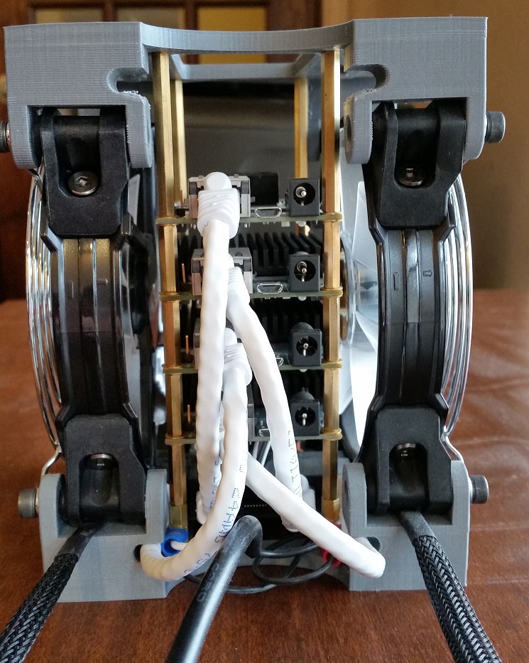

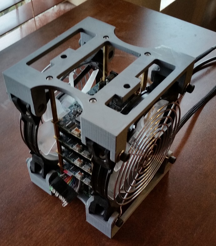

Here are some pics of the finished product in ABS grey.
Top-Right View
The dual 120mm fans are a bit of overkill. I had planned to use the inline resistors that come with the fans to reduce their speed. These get pretty hot, so I was going to use the heat for some old style Christmas bubble lights and some brass tubes to steam-punk the final design. Maybe add an old style Ammeter to indicate the gigaflops generated.

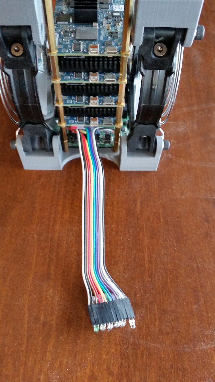

Front View
The network switch LEDs were in the way of the posts that hold the Parallella-16 boards, so I extended them with some ribbon cable.
I had planned to mount these LEDs higher (hot melt glue? or modify the 3D base?) where I could see them from a distance.
Rear View
I notched our the base to allow for the CAT5e cables and I cut down some of the plastic around the connectors to fit around the brass posts.

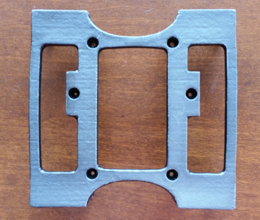

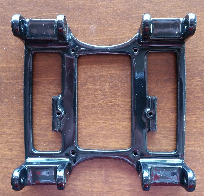

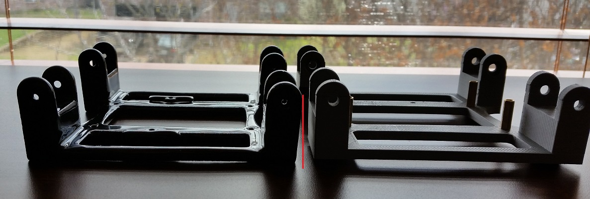

The folks at Shapeways.com gave me a credit to try them out. Since it was free... I had them build a base out of ceramic.
Ignoring the fuzz and dust in the picture... the result was ceramic... with a gloss black finish.... but it is not precision enough for the application.
When it was fired, the fan mounting posts spread right and left. You can see some additional distortions in the second picture.
Top down
Ceramic Base
Underside
Underside of base
Side view - Ceramic base versus plastic base
Side
