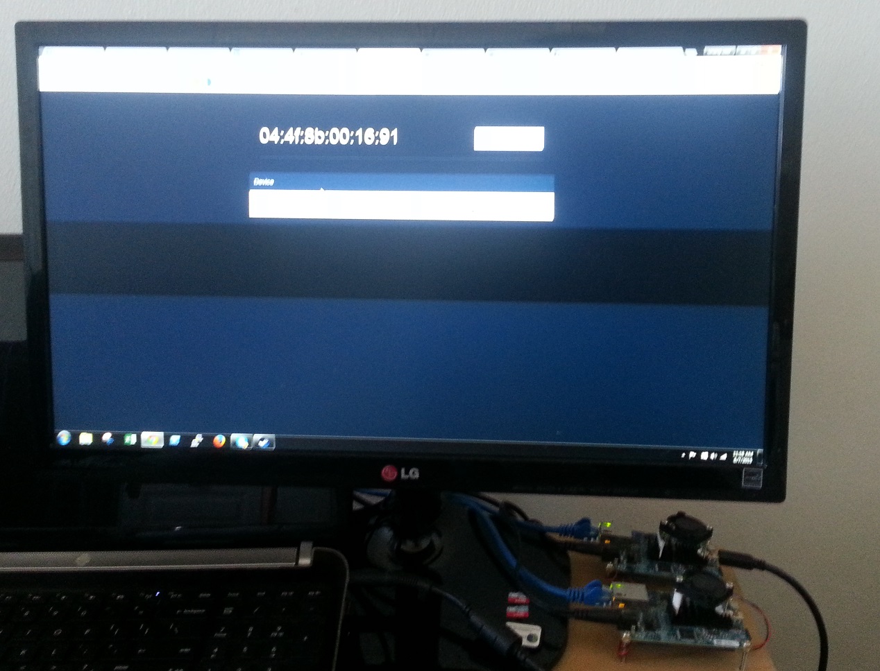

Postby jubertroldan » Sun Jun 07, 2015 1:52 am
Hi Guys,
got my boards fired up and running, left it overnight and can see the mac adds on the search now..how ever if this would be running 24/7 its a bit noisy on my current set up..
