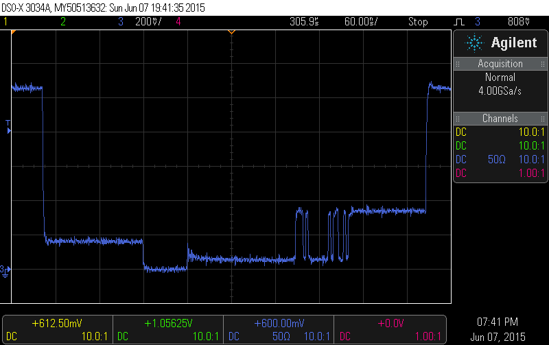

Here are a few capture looking at the 'P' signal of data lane 0.
* This is a capture of a "Frame Start" packet :
You can clearly see the influence of the termination resistor on LP-mode. When this signal goes to '0' but the other one is still at '1', this signal isn't going down all the way to 0v but more like 200mv. Then finally when the other signal goes to 0 too, then both are at 0V until the HS drivers are enabled.

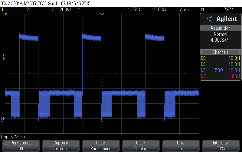

* This is a capture of several lines of data when shining a flashlight at the camera.
You can see the block of data stuck at '1' where the image is saturated.

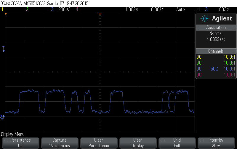

* This is a zoomed in view of the header of a line of data
You can see the SoT sequence followed by the data type identifier for 'RAW10'.

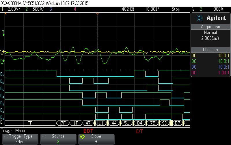

It seems the IO can indeed capture the data without much trouble. Below is the capture of a shift register where I save the last 8 captured bits on data lane 0 :
(Note that due to layout of my gpio breakout, the P/N pairs are swapped and so every bit is inverted)
You can see 0x47 ( = 0xB8 ) which is the SoT (Start of Transmission) sequence for the link synchronization. And then 4 cycles later (i.e. 8 DDR bits later) : 0xD4 ( = 0x2B ) which is the Data Type identifier for RAW10 data frame. (and yes, on the picture I screwed up and marked 'EoT' instead of 'SoT').
The test setup looks at the state of a shift register inside the FPGA that I exported to some other GPIO so I could monitor it with my scope because I don't have JTAG on this breakout board and so I can't use chipscope :p Don't pay attention to the analog trace signal quality, the grounding lead was not properly setup for those high speed signal and I was just using it to trigger on the LP -> HS transition.
