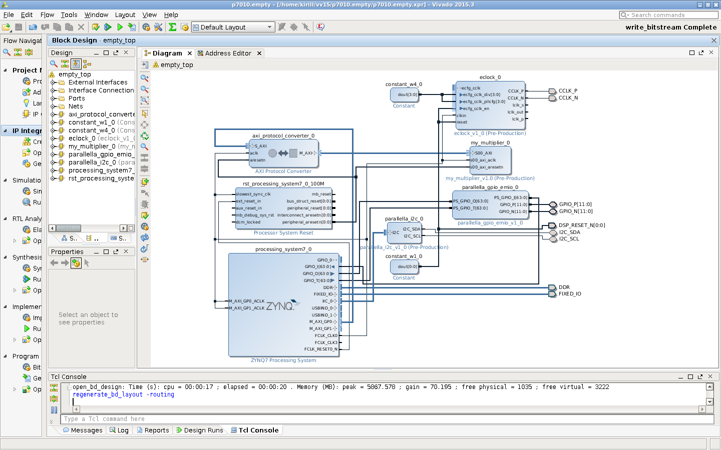

I'm working on exactly that. So far I managed to create an emptyish design with only few bits from e-link library present. See attachment for screenshot. I had to remove TX/RX ports and also removed them from constraints file, it's probably safe so long as you don't create your own ports and accidentally attach them to TX/RX pins connected to Epiphany and use wrong voltage or direction.
My design worked, I tested it with bare metal app, but Linux didn't want to boot with that bitstream, after changing bitstream back to official, things worked ok as before, so I didn't fry anything. But then I also didn't leave it running for a long time either, so who knows.
It will take me some time to turn that into a step-by-step guide, but I plan on doing just that.

looks like you disabled USB0 and USB1.. as these are wired in on the PCB I would have left them enabled... they might be configured in the bootloader. I would double check the processing_system customization for things that might have affected linux boot in some way and in general if its on the schematic so you cant use the pins anyway I would check how to disable it correctly or leave it in. I dont think that the lack of epiphany will cause the epiphany driver any problems and anyway you would see the problems in the boot log with a hint to the problem area. It there is no boot log from the serial port then its got to be something very early on like clocks or quad spi flash or something that the bootloader wants but cant find causing it to crash... just a guess.

I had more time to look into it. First, I haven't changed USB settings, the only thing I changed on processing_system is disabling of AXI slave interface. I have now added "console=ttyPS0,115200n8" to kernel boot args and was able to see that it boots just fine and gets pretty far into the boot process, but then something gets triggered in user space and no more progress is made. I then added "init=/bin/dash" and was able to get to shell. My guess that it's some parallella specific service, maybe thermal watchdog that triggers hanging when eLink is not present in the bitstream.
