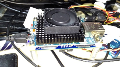

Postby KenichiSIT » Tue Mar 01, 2016 2:32 am
I'm cooling it with a fan.
