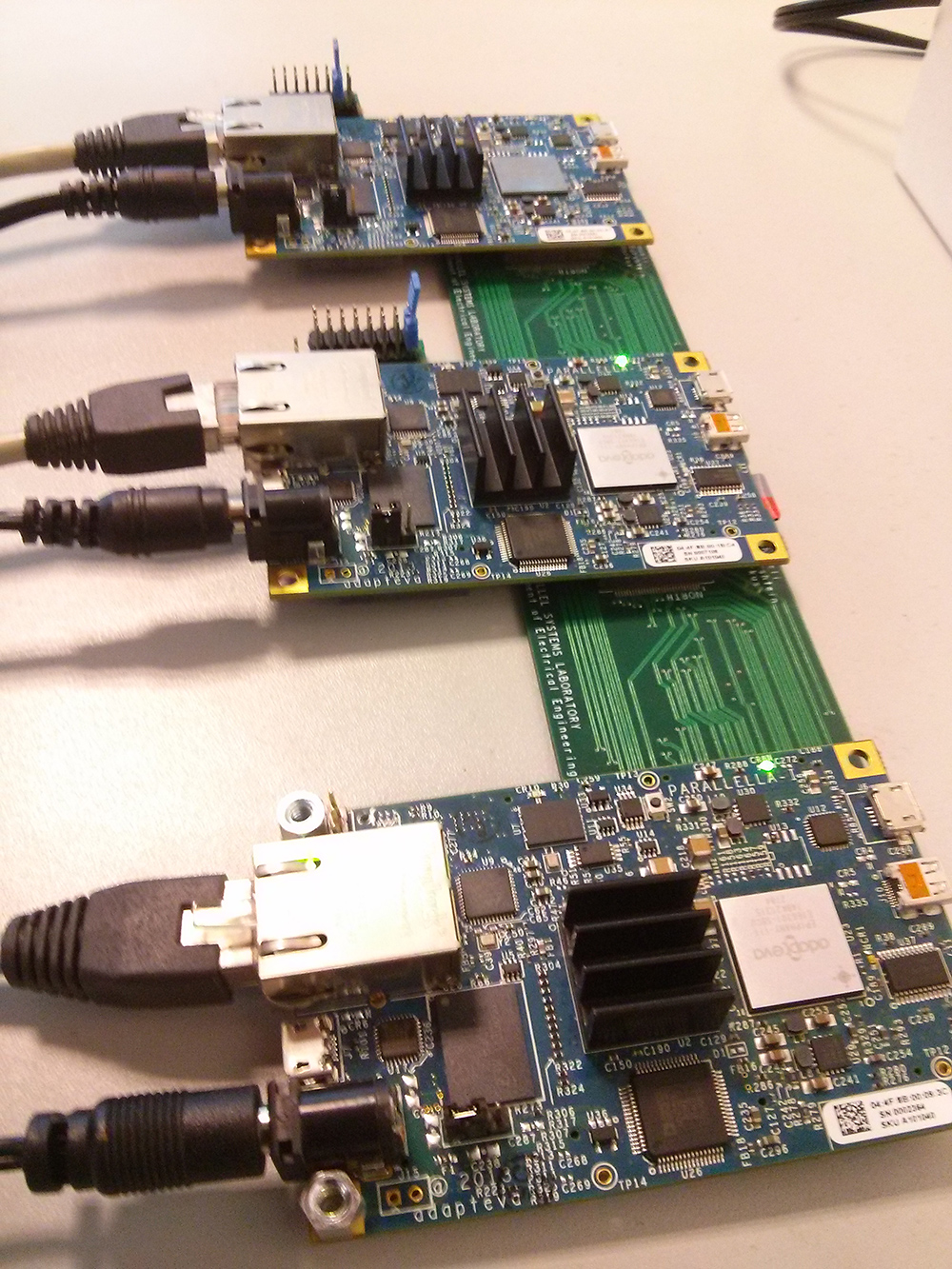

We have spent the last few months playing with the Parallella and trying to make several boards work together. We came across several problems that we could use some help solving.
At first we followed this post: https://parallella.org/forums/viewtopic ... r&start=10
with the old HDMI Build, and connected our boards this way: (link attached in case you cannot view the image)
https://drive.google.com/file/d/0B5uBXg ... sp=sharing
Then we made our own new PCB connector:

Hello everybody,
We are glad to tell you that we succeeded! Thanks to a lot of help from Peter and others, and a lot of time and effort,
We managed to build our very own Parallella Epiphany level cluster!
We wrote a user manual, some example code, and a technical report- all available in the link:
We also added the design files to the same folder.
Hope this helps some of you! please let us know if you use it or have any issues!
