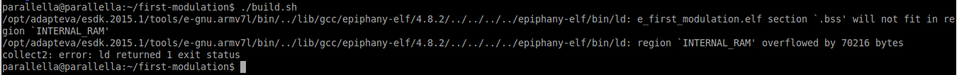

i have a problem with internal RAM when i try to run my project , any suggestions that can help me ?

First: Do not take screenshots from error messages, but copy the full error message instead.
The error message (at least the part I can see) simply means that your code does not fit into internal RAM. You only have 32 KB of local memory per core, but your code tries to use more than 100 KB.

It is impossible to fit 100 KB into a 32 KB big memory.
What you need to do depends on your code, your algorithm and your approach to the problem.
You can slice your data, you could use other core's memory for storage only, you could use external memory. All of these solutions introduce overhead.
