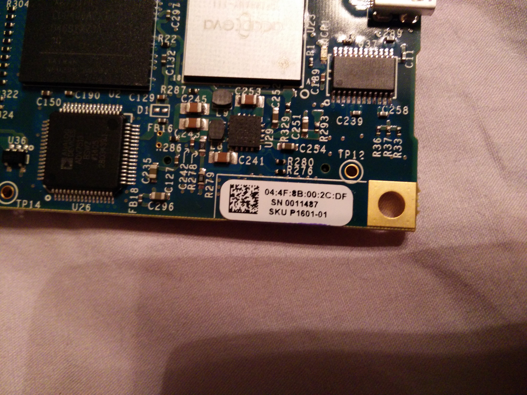

The mystery is solved...
I was reading through some older posts on the board here and someone mentioned having a "Kickstarter" desktop Parallella with a Z7020.
I recalled that I did receive my Parallella through Kickstarter and that possibly I have the 7020 and not the 7010.
I could not read my Zynq die as it's now covered with a thermal pad and I didn't feel like taking it apart. Long story short, I downloaded
the Z7020 headless image and attached the serial cable. It booted without issue. :o
So I should be all set now. I had forgotten that the older boards were actually 7020 but are still the desktop addition (with USB and HDMI).
Problem solved. I expect the HDMI image should now work and I'll try that next.
Anyway, if anyone is seeing the messages about the FPGA bitstream not loading, check the Zynq package and ensure you've got the chip you think you have.

Thanks, that is helpful. I will try a few things:
1. Identify definitively what model Zynq I have with getfpga tool.
2. Capture the full boot log from the serial console for further debug.
3. Capture output of i2cdetect.
That begs the question (assuming I actually do have a 7010) why is it that the 7020 boot images work (at least to support the ARM host) but not the 7010 versions? For the 7010 images, I can't even boot.
It really does appear that I have a bad board at this point. I have since tried multiple brand new SD cards, verified the SD images, and verified all cables and equipment. The 7010 images simply will not boot.
mchampigny
Posts: 27
Joined: Fri Dec 02, 2016 2:56 am
Re: Bad device MMC causing boot failure
Postby mchampigny » Tue Dec 20, 2016 3:02 am
Here is a follow-up with some additional information.
I confirmed (with getfpga) that the chip is a 7010. That explains why the eLink support is broken. The bitstream is invalid since I am using a 7020 image. However, the 7020 image at least allows me to use the ARM host. I cannot even get to a boot prompt with any of the 7010 images.
Here is the output i2cdetect. It doesn't look good:
0 1 2 3 4 5 6 7 8 9 a b c d e f
00: -- -- -- -- -- -- -- -- -- -- -- -- --
10: -- -- -- -- -- -- -- -- -- -- -- -- -- -- -- --
20: -- -- -- -- -- -- -- -- -- -- -- -- -- -- -- --
30: -- -- -- -- -- -- -- -- -- -- -- -- -- -- -- --
40: -- -- -- -- -- -- -- -- -- -- -- -- -- -- -- --
50: -- -- -- -- -- -- -- -- -- -- -- -- -- -- -- --
60: -- -- -- -- -- -- -- -- -- -- -- -- -- -- -- --
70: -- -- -- -- -- -- -- --

The data is very confusing! To help us understand, can you post?:
1.) The exact model number on the board sticker
2.) The exact name of the image you are using. (in fact, if you could take a picture of the board without the heatsink it would be very hepful.)

Postby mchampigny » Wed Dec 21, 2016 2:57 am
Andreas,
The attached pictures should give you all the information you need. The image I used is:
https://github.com/parallella/parabuntu ... 020.img.gz
This is found at the "Quick Start" link on parallella.org. Notice that even though the CPU on the board is a z7010 I could only boot into the ARM host with the z7020 image. I have never been able to boot the z7010 images on this board.
Thanks.
