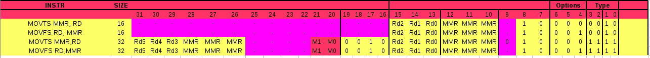

I'm trying to make a simple llvm backend for Epiphany CPU (originally based on Hoenchen's code, later decided to rewrite it from scratch using Cpu0 backend writing manual as a reference), and I'm getting stuck at some places.
As subject states, it's about arch reference doc. In the instruction set table (Appendix C of the PDF) there's a number of empty spaces, e.g. in MOV(imm)32 instruction. I originally assumed those spaces to be zeros, but after compiling the same code with e-gcc and my backend it turned out that bits 16-19 (empty ones) should be assigned to 0b0010, similar to MOV(reg)32 instructions. There's also a number of empty spaces in math-related instructions, so i want to ask if i'm missing something, or maybe there's a full table somewhere with those spaces filled?

For the irregular instructios that are one or two operand i structions, we make RN=RM to simplify HW.
Most up to date doc sources are here. If there is something missing or unclear we will fix it.

So, I was talking about MOV IMM 32 instruction from IMM-INT section. In both pdf and .md file over the link, bits 19:16 are marked as "xxxx" aka "Don't care, should be zero for forward compatibility".
But e-gcc sets them as 0b0010, similar to all other MOV instructions. And using e-objdump to disasm the ELF results in *unknown* instruction unless those bits are set to 0b0010. Which way is correct, zeros or e-gcc way?
Those bits are neither RM nor RN in any other instructions.
