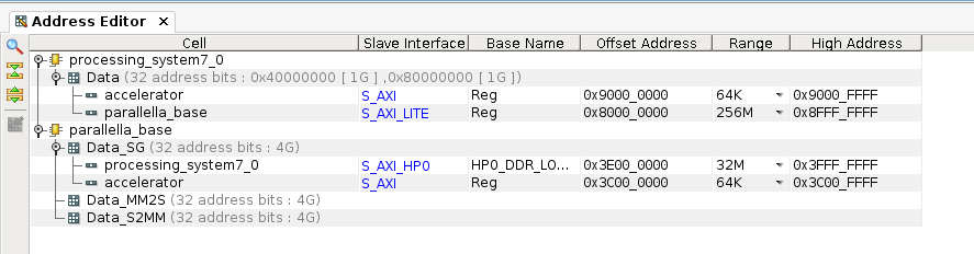

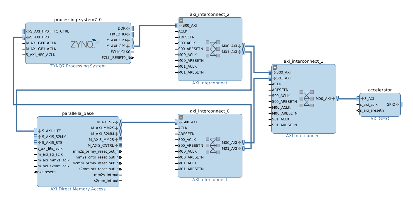

Postby olajep » Fri Jun 30, 2017 2:05 pm
