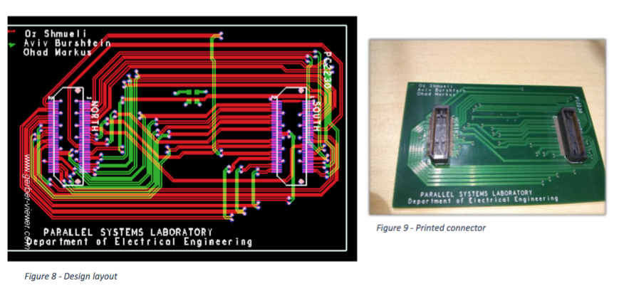

Well, about cables you have two alternatives:
1 - purchase the Parallella eLink cables here already done (18 Pounds plus shipment)
2 - purchase >40 flat cable (of 1mm, not standard 1.27mm) and the 40 pin female plugs. It's easy to press the flat cable to grip the contacts
Let me know about your progress, keep us in touch!
claudio4parallella
Posts: 70
Re: Two Parallellas eLink cluster (interconnected)
Postby dejan » Mon Nov 13, 2017 2:57 pm
I do not have the porcupine board... :(
dejan
Joined: Mon Jun 16, 2014 3:37 pm
Postby claudio4parallella » Mon Nov 13, 2017 5:55 pm
without a Porcupine (http://www.digikey.com @ 35$), you need this DIY...
