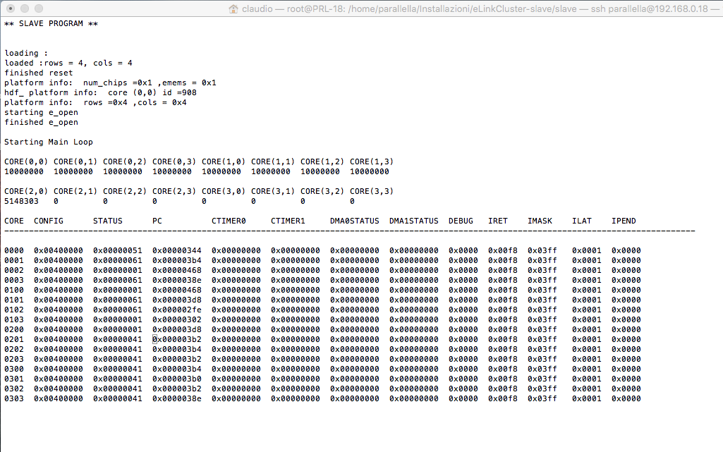

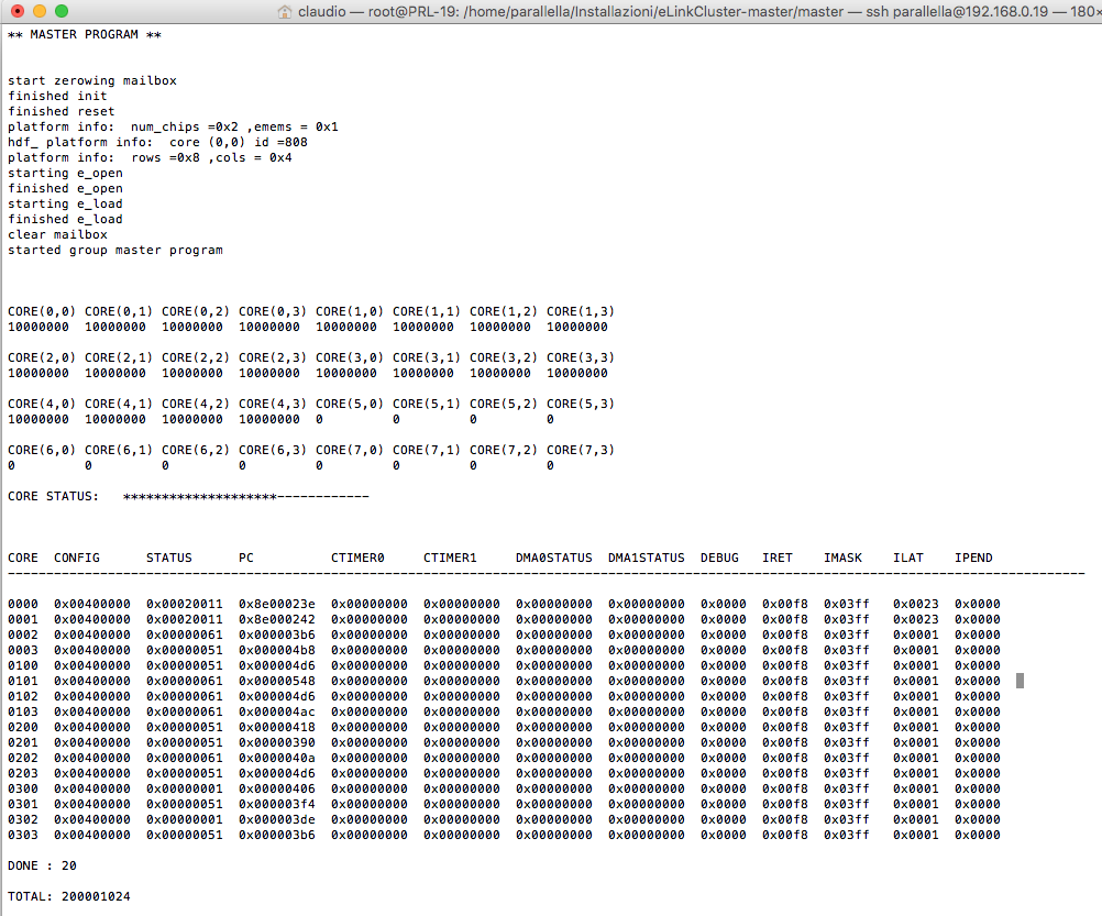

Here are my terminal screen of the eLink 2-Parallellas/Porcupine
SLAVE showing in a loop the local 16 Cores and Registers
MASTER showing in a loop the 32 Cores output, the total of output, the core-done counters
The 32 Cores are activated in sequence: core00 when reach 10000000 activate core01 and so on...... up to core73
Master Parallella shows the 32 Cores
Slave Parallella shows only local Cores

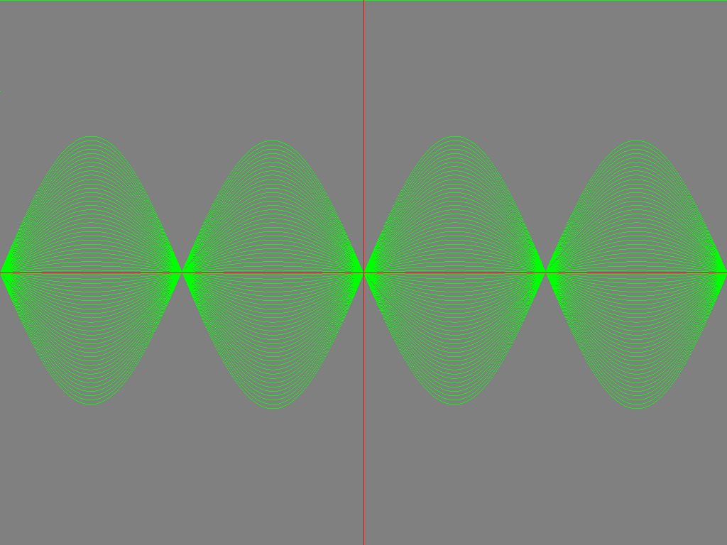

Postby claudio4parallella » Fri Oct 13, 2017 9:43 am

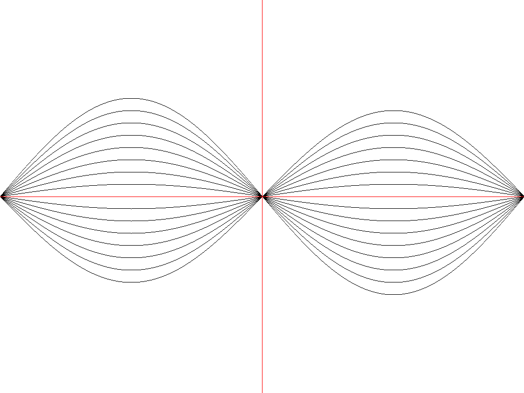

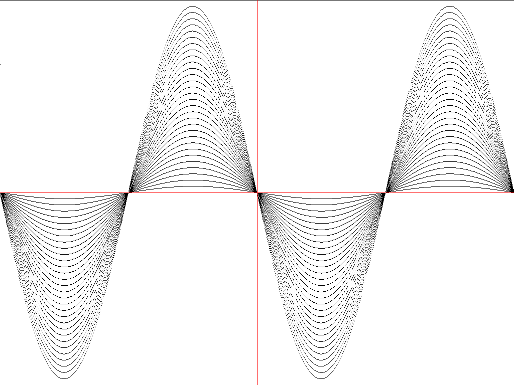

Proof of concept results of two eLinked Parallellas in cluster (Master-Slave)
Purpose: realize synchronization between multicores in eLink cluster with individual tasks
Lesson learned:
- core 0 of MASTER parallella must be used to read/write/synchronize all the cores in Master Epiphany and Slave Epiphany
- internal.ldf works ok, not other choice
Attachments of resulting images:
1. example of a single Parallella: the 16 cores individually are drawing a 1024 step of Y=sin(alpha) [0..2Pi]
2. example of a dual eLinked Parallellas: the 31 cores individually are drawing a 1024 step of Y=sin(2*alpha) [0..2Pi]
Next step: 4 eLinked Parallellas and 64 cores
2 Parallellas 32 cores
One Parallella 16 cores

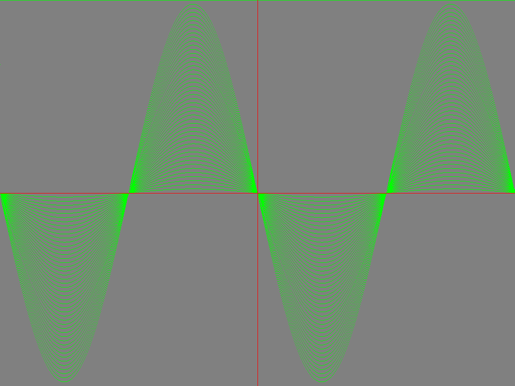

Postby claudio4parallella » Fri Nov 03, 2017 9:20 pm
Wow! I found a Zynk7020 Parallella !
In the meantime the new board will arrive....
and my eLink cluster will become a full 64 cores machine
here attached is the 48 cores single kernel-by-core Proof of Concept
