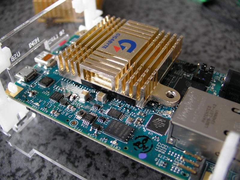

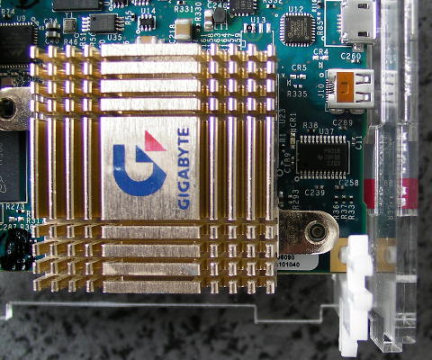

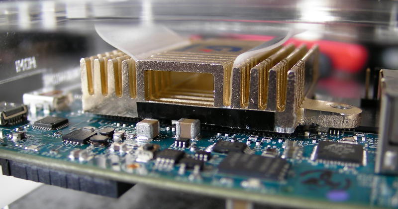

This one fits exactly. There are some small caps at the north-west quadrant so I taped the underside of the heatsink there.

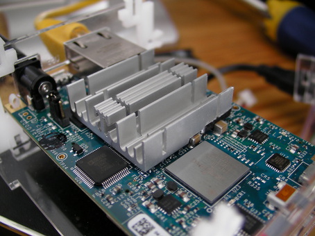

As it stands, I'm going to look into a smallish fan and blow it over two differing heatsinks. I've got the one in the box that Adapteva thoughtfully provided, which may/may not be adhered by way of the tape on it or Artic Alumina- and I've got a bevy of RAM heatsinks I bought on eBay a while back for re-doing the thermal management on my Equiso HDMI sticks so they're stable. It should handle the Ephiphany decently enough. A low airflow mini-fan should quietly fix the thermals. Now...thinking on how to do this without boogering up my nifty case TOO much. :twisted:

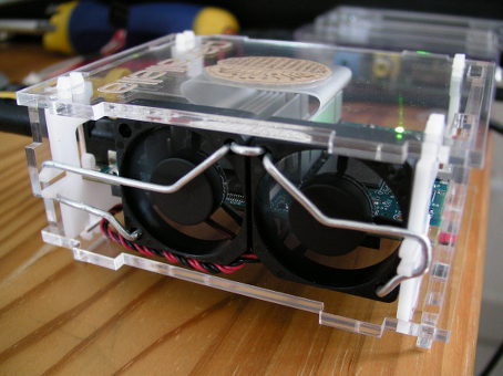

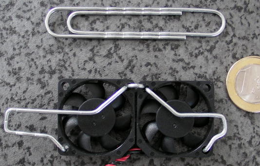

What I've done instead is make a metal bracket to hold two 30x30x6mm fans in place of one of the long sides:
The bends at the left and right extremes need some adjustment but it clips nicely in place already.

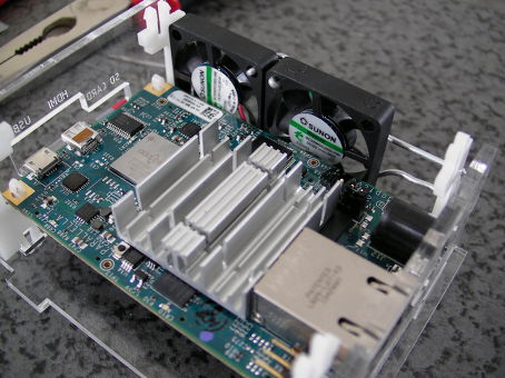

That's too much but I want to see what happens. To maximise the airflow I leave the opposite long side off and the top lid on.
The power source is a solid 3A and I'm running the headless configuration so there is enough power for those two fans. They are the 30mm variant of the 25mm mentioned in other threads; the whole catalog is here:
The smaller variant would be better because it's quieter, and with the metal bracket I have a vibration and resonance problem so I'll try things like removing one and adding dampening. Right now it sounds like a small server, but those guys do bring down the temperature a few more degrees than the 92mm 12v running at 5v I've used until now.

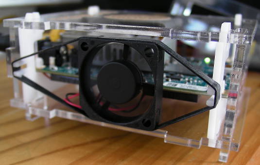

The best result I can report is the following super-simple and effective rubber band mount for the fan:
I wish I had thought of this earlier.
The band is a slice from a mountain bike tire; quick to make and fit, and very adjustable: sliding the band on the plastic mount points up or down changes the tension on each side of the band, the tighter side pushes the fan in the opposite direction, and you can then adjust the vertical position to the millimeter.
It also holds fans of different thicknesses, so instead of 6mm it could be a more common 10mm or even 15mm. A deeper tunnel makes the fan more efficient and I think you could get the same amount of airflow with a slower-spinning and therefore quieter fan.
