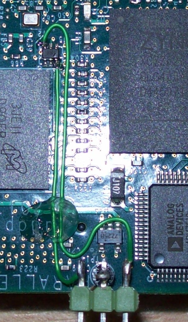

UART/Console port
To play with the kernel or bootloader or just general debug, it's essential to have access to the serial port. Unfortunately on the rev0 it's only accessible through the PEC and not via a standard .1 inch header like it will be on rev1.
Solution is simples, just add the header ! On the picture below you can see where to connect, I just soldered a 3 pin header using the center pin as ground soldered onto one of the GND 'post' for mechanical support and then just ran a couple of 30AWG wire to the buffer chip.
UART connector
Force IDSEL low
If you want the use the USB host port, you need a cable that pulls the IDSEL pin low for it to work currently. Mine didn't have that which meant the port didn't really work (no power basically). I'm not planning on using that port as a device port, so the solution is simple, just force it low in all cases.
Again, AWG30 to the rescue and there is a resistor in the IDSEL path which is conveniently located near a big GND pad.
IDSel forcing

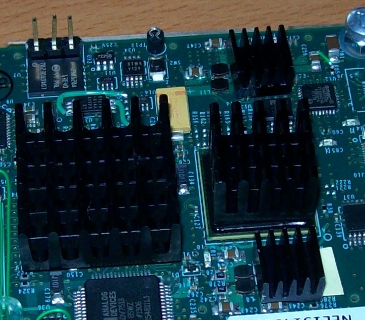

Heatsinking
As mentionned elsewhere, the board heats ... a lot ...
The rev1 should be much better but I still wanted to be able to use this rev0 normally without worrying about thermal issues. So I added heatsinks to all the main source of heat. The zynq is easy, it's nice and very flat. The epiphany is not flat at all so it's not great. I used thicker thermal adhesive but still the contact area could be better. The other chips that heat a lot are the PMIC (voltage regulators). I used two very small heatsinks for them, just beware not to short any of the capacitors nearby. I had to cut a bit of the aluminum on the bottom of those to avoid issues.
Heatsinking
Fan
Despite the heatsink, if the air is stagnant, they get hot. Too hot. The epiphany will start producing wrong results and the zynq has weird behavior. So I took a sunon quiet 5V fan and stuck it to the side of the board, connected in parallell to the 5V input supply.
You can barely hear it and the board is now very cool and very stable.
Fan
