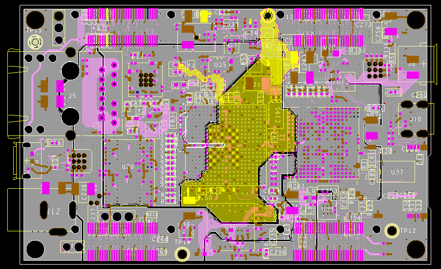

We did make a change to the gen 1.1/1.1 board due to feedback from folks with intent to really beat up on this board. The through-hole in question is TP13 and the picture below shows that this power might just be good enough to feed more current to the Zynq. Since this is very much an experimental feature, we need help testing it. Since the board runs quite hot with 5 Watt, cooling is going to be a an even bigger concern as you use even more of the Zynq device.
NOTE: You MUST ground the REG_EN1 through the PEC_POWER connector input if you are going to drive power directly to TP13 from an external supply. If you don't, you WILL break the board.
