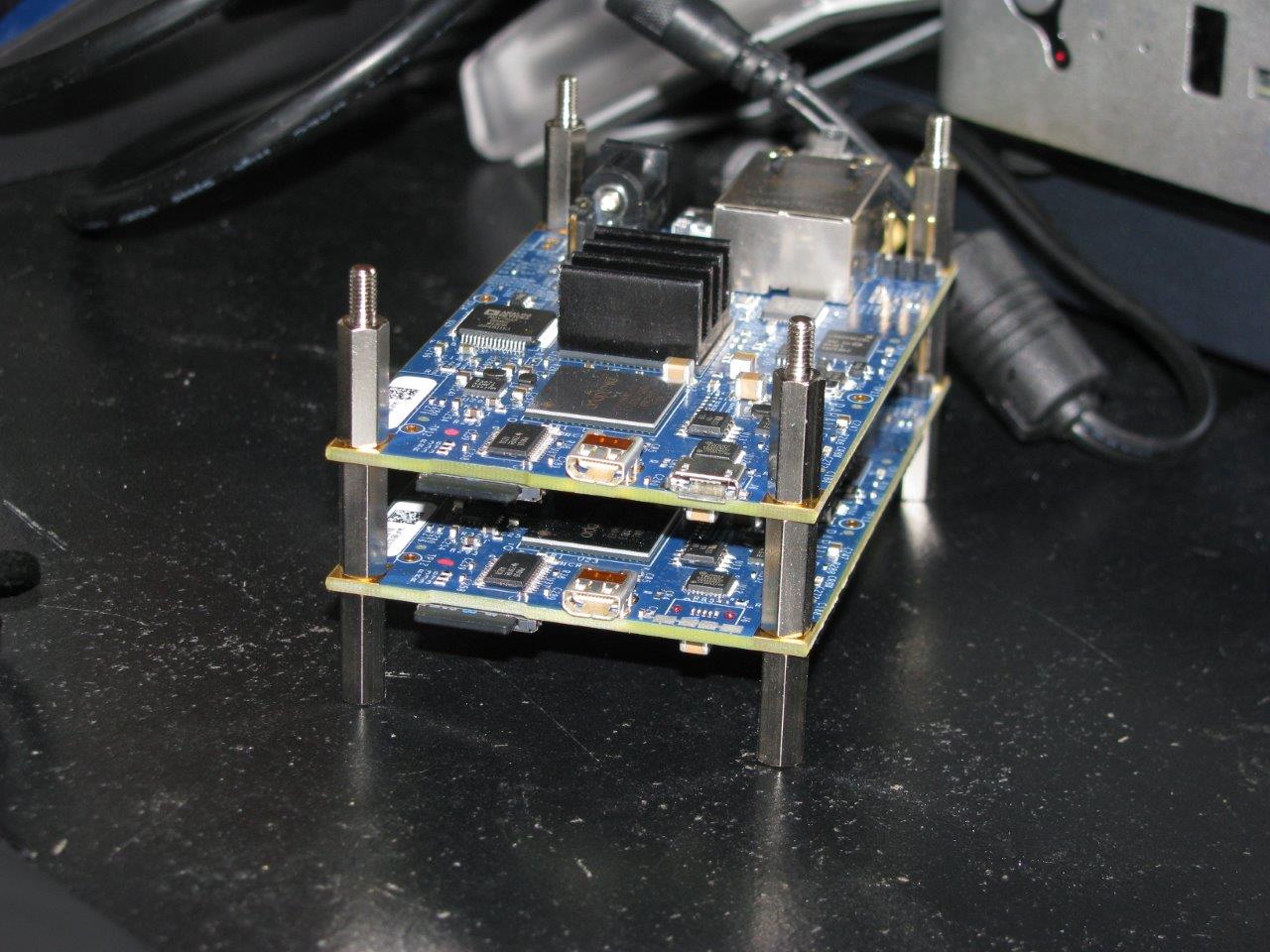

> Are you saying one of the connectors on the Parallella broke? Can you post a picture? We probably have 1000 inserts at this point and > haven't seen a problem, but if there is a problem we need to fix it quickly!
> Thanks,
> Andreas
Attached, see lower board. Popped off the solder pads due to a tight uUSB adapter, and no I didn't push hard or misaligned. Note also the upper board uHDMI connector is loose and need to be reseated into the pads periodically, and that adapter wasn't even tight.
Let's face it, the micro connectors are pretty fragile and unrobust compared to the original huge A connectors like the Pi uses, or even the older intermediate C mini size (which a lot of things still use). Totally understandable why you had to use them from a board space perspective (the board is seriously packed, just look at it side to side with a Pi), but there's a cost which is that people will be plugging unknown adapters from Microcenter in for their keyboards and some of them will be tight. You could supply A female- D male adapters that you have tested for being good fits, since people will need them anyway to plug their hubs into, since you haven't made the second uUSB work yet. (The Pi ducks that issue by giving you 2 for key/mouse).
