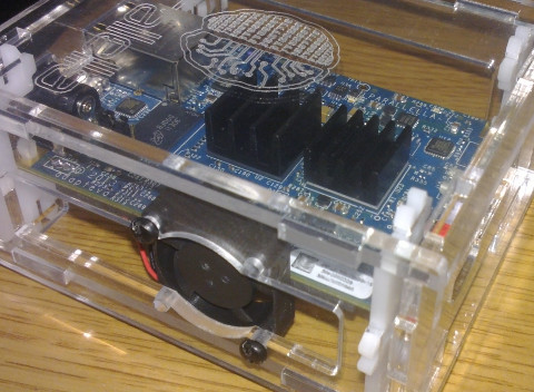

Postby bszente » Mon Jun 02, 2014 11:13 am
Parallella board with fan
