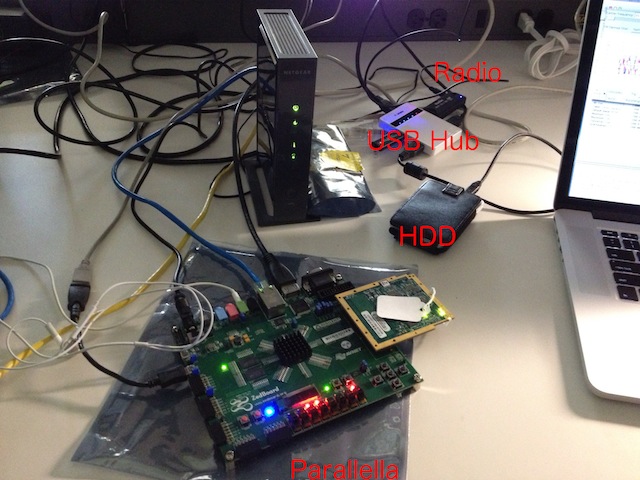

Postby tjt7a » Fri Apr 19, 2013 4:31 pm
I ssh into the Parallella and forward X to get the gnuradio-companion on my laptop.
Some screenshots of what I have working right now:
Hardware Setup:
Hardware
Photo Apr 19, 12 15 25.jpg (100.26 KiB) Viewed 69596 times

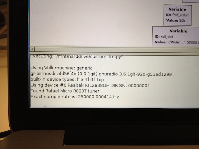

Successfully Reading From the USB TV Tuner:
Reading From TV Tuner
Photo Apr 19, 12 15 53.jpg (70.42 KiB) Viewed 69596 times

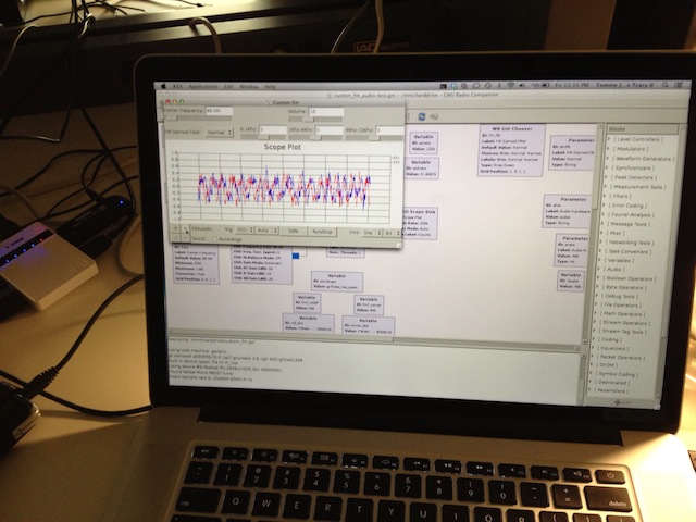

GNU Radio Scope view of FM demodulated signal at 89.5MHz:
89.5
Photo Apr 19, 12 15 17.jpg (89.56 KiB) Viewed 69571 times
