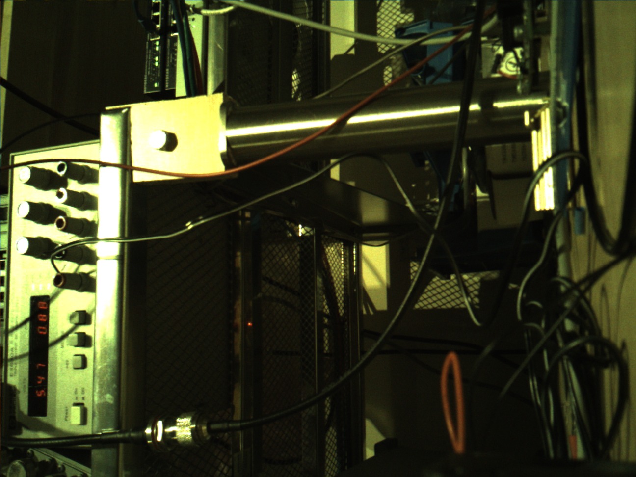

Postby tnt » Wed Jun 24, 2015 9:07 pm
Ok, got it all working on the rev1 with the porcupine :)
Attached is the first image captured.
It's getting a bit late so I'll do some minor cleanup of the rough edges and publish a first prototype for people to try tomorrow. Just something that takes a single frame or so.
In the mean time you can start doing the hw mod to the porcupine that you'll need to try it. (at the moment this is still needed, I hope to lift that requirement).
