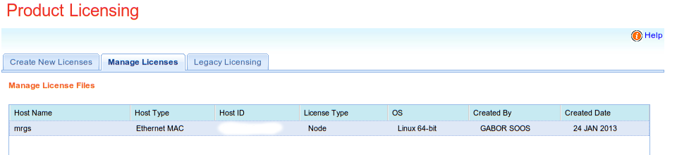

Well, I am a newbie at the Xilinx ISE, but 'it seems' working for me. I obtained an 'personal' / free licence for webpack. I can reach all?! functions (simulation, analysis, synthesis, implementation, programming ... ) with this (installed on a GNU/Linux 64bit host via ISE installer). So, get Your 'free' bytes. Regards, Gabor

Oops. As I understand, he is talking about 'just' a license problem ;) . Sorry. I will check the 'coregen' function too. Regards, Gabor --- It should to in the package, based on the WebPACK leaflet. ---
