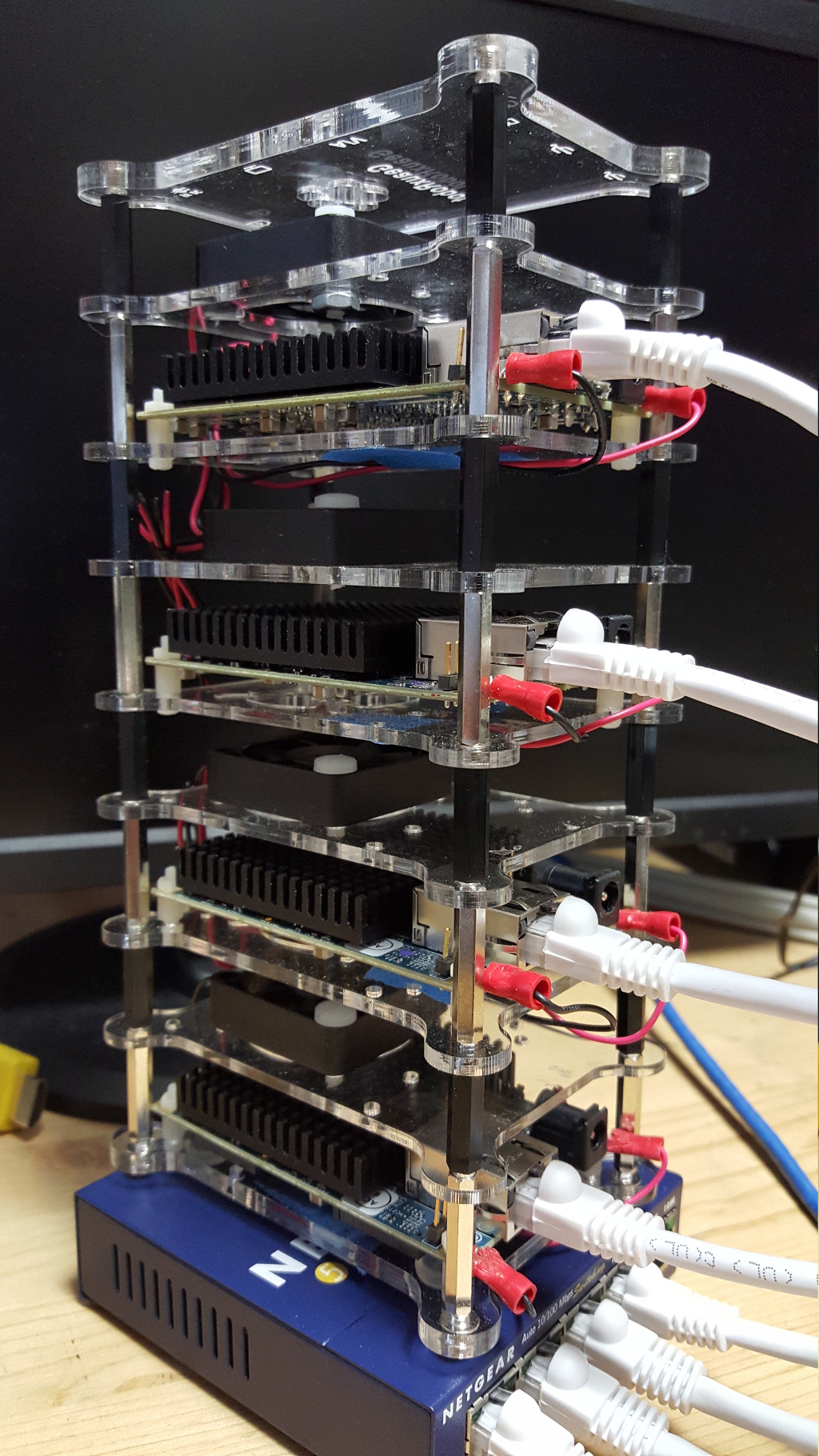

I have assembled a cluster case from GeauxRobot's Raspberry Pi stack enclosures (base plus stackable extensions). Because I have mounted a fan on the top of each Parallella, I needed to put extra spacers between the layers. The metal standoffs are 25mm+6mm M3 and the nylon standoffs are 20mm+6mm M3. The GeauxRobot layers require drilling 2 extra holes in each for the board standoffs and, because of the layout of the layers, the spacers do not interact with the Parallella boards. This means I can have my fan powered by the board and yet not interfere with the electrics.

Thanks for sharing, that's a nice looking rig. I will consider that case.
